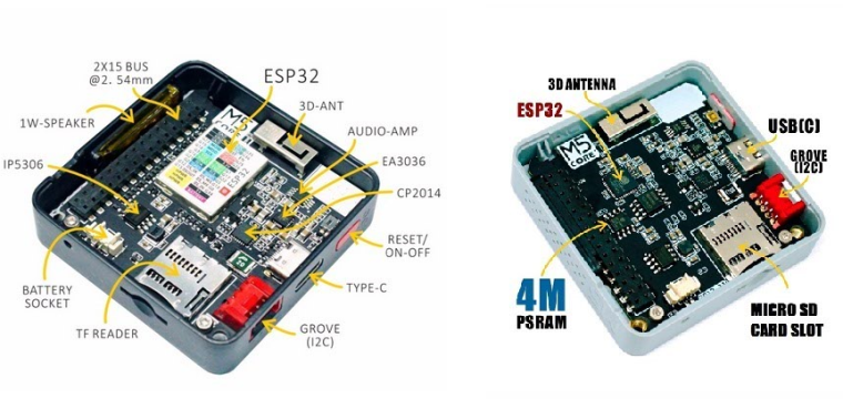

<p dir="auto">Thanks for your reply, I can't reload the Factory Test because the computer can't detect the COM port when I connected the device by USB cable, I guess the board already have something defected.</p>
<p dir="auto">Refer to your picture, the heat is mainly come from the CP2014, do you have any idea what's wrong?</p>

]]></description><link>https://community.m5stack.com/post/909</link><guid isPermaLink="true">https://community.m5stack.com/post/909</guid><dc:creator><![CDATA[hypnos]]></dc:creator><pubDate>Mon, 30 Apr 2018 18:53:59 GMT</pubDate></item><item><title><![CDATA[Reply to Overheat on Mon, 30 Apr 2018 18:12:12 GMT]]></title><description><![CDATA[<p dir="auto"><a class="plugin-mentions-user plugin-mentions-a" href="/user/hypnos" aria-label="Profile: hypnos">@<bdi>hypnos</bdi></a> Hi hypnos,</p>
<p dir="auto">I've only had the M5 heat up from one sketch that I tried.... was the Oscilloscope sketch and audio had not yet been disabled and the speaker was highly active.... was quickly fixed and no heatup after that.</p>
<p dir="auto">When u said "and seems I can't detect the COM for this device anymore.." do you mean you can't establish a connection to the M5 using the USB connection ? And that it no longer appears on your COM port ?  It should still connect with the bottom module disconnected.</p>
<p dir="auto">(With the bottom module connected if necessary...) You could try loading a basic sketch (Factory Test) and see if it is still heating up.</p>
<p dir="auto">Can you identify any specific area of the unit that the heat is coming from ?</p>
<p dir="auto">Here is a picture of the two different M5 models:</p>
<p dir="auto"><img src="/assets/uploads/files/1525111704796-5eca4a63-d95b-4a75-913a-881dd5c52a9e-image-resized.png" alt="0_1525111700799_5eca4a63-d95b-4a75-913a-881dd5c52a9e-image.png" class=" img-fluid img-markdown" /></p>
