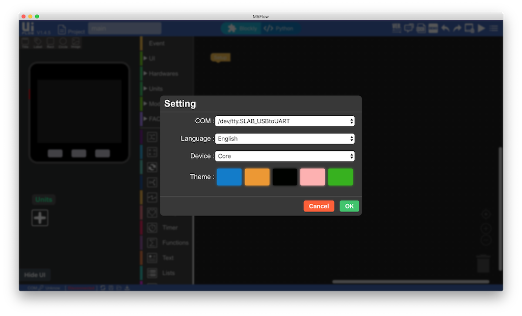

<p dir="auto">I've downloaded and installed the latest MacOS driver from <code>silabs</code> (<a href="https://www.silabs.com/products/development-tools/software/usb-to-uart-bridge-vcp-drivers" target="_blank" rel="noopener noreferrer nofollow ugc">https://www.silabs.com/products/development-tools/software/usb-to-uart-bridge-vcp-drivers</a>), and then installed the latest uiFlow Desktop IDE.</p>
<p dir="auto">With the device connected to my Mac via the provided cable, when I open the IDE, it lists the device, but fails to connect.</p>

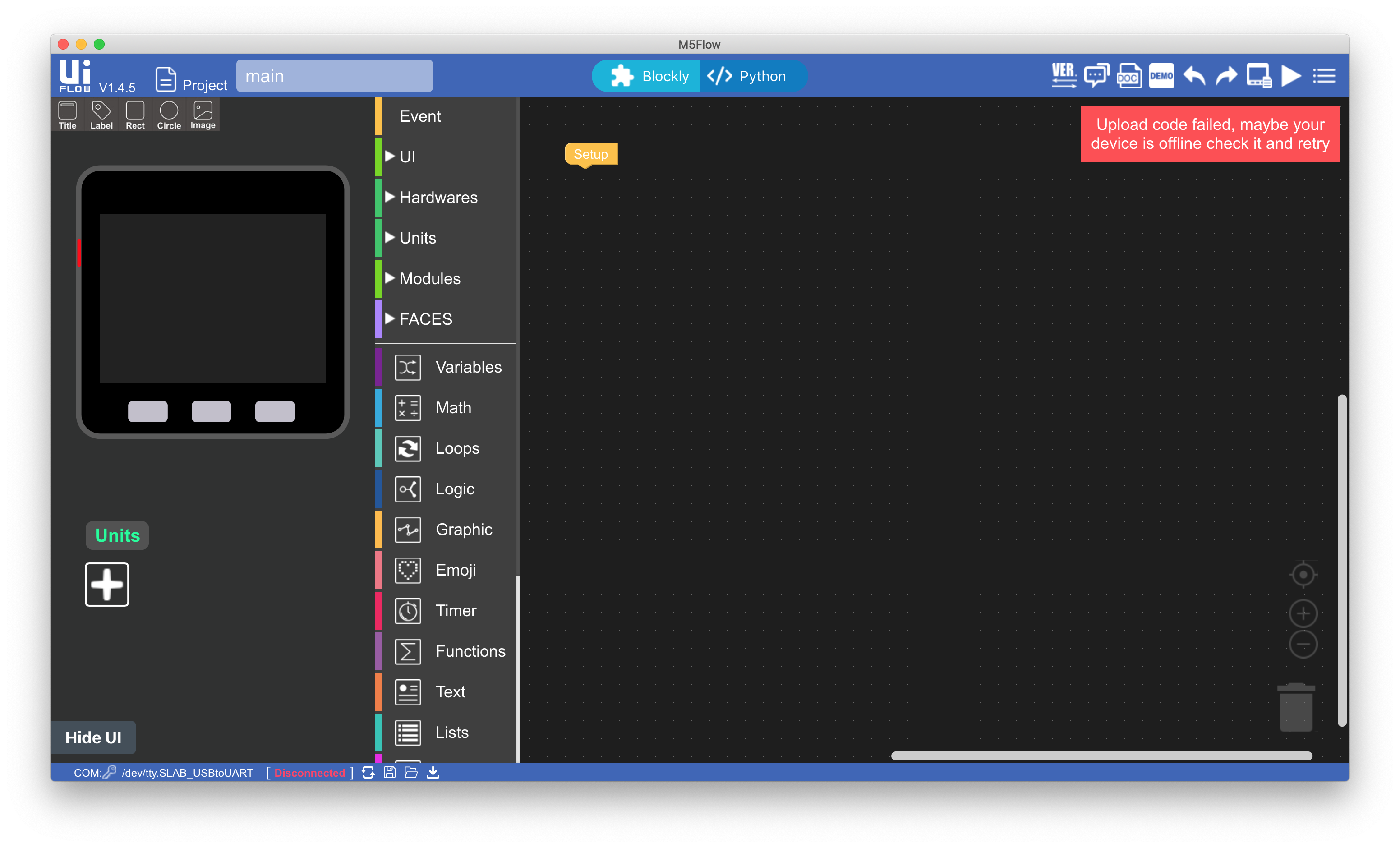

<p dir="auto"><img src="/assets/uploads/files/1588548183404-uiflow-ide-list-device-resized.png" alt="0_1588548180327_uiflow-ide-list-device.png" class=" img-fluid img-markdown" /></p>
<p dir="auto"><img src="/assets/uploads/files/1588548197389-uiflow-ide-error-resized.png" alt="0_1588548186519_uiflow-ide-error.png" class=" img-fluid img-markdown" /></p>
<p dir="auto">I'm not sure how to proceed now. Please let me know if there is any other information I need to provide.</p>

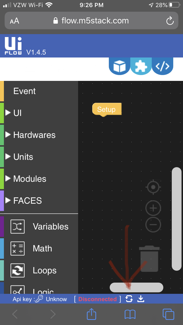

<p dir="auto">When it fails for me, I just keep trying over and over until it works. Sometimes it takes 3-4 times for me. Also try to hit the refresh button at the bottom left of the UI to see if you get “connected” before uploading your flow to the M5Stack.</p>
<p dir="auto"><img src="/assets/uploads/files/1588814886264-4d2cfa49-62d4-46cc-9901-38a0e5616cc7.jpeg" alt="0_1588814874635_4D2CFA49-62D4-46CC-9901-38A0E5616CC7.jpeg" class=" img-fluid img-markdown" /></p>

<p dir="auto">Now, I'm able to connect to it from the desktop IDE via USB (when set in USB mode). I had to restart my Mac, though, for things to work.</p>
<p dir="auto">One problem, however, is that it still doesn't connect to the device in <em>Internet</em> mode, via <a href="http://flow.m5stack.com" target="_blank" rel="noopener noreferrer nofollow ugc">flow.m5stack.com</a>. After I enter the <code>APIKEY</code> displayed in the device screen, I keep getting the same <em>Upload code failed...</em> error in this mode.</p>
<p dir="auto"><strong>UPDATE 1</strong>: Looks like another user, <a class="plugin-mentions-user plugin-mentions-a" href="/user/spoetnic" aria-label="Profile: spoetnic">@<bdi>spoetnic</bdi></a>, seems to be reporting a similar issue with the Internet approach (<a href="https://forum.m5stack.com/topic/1920/ide-crashes-after-startup-and-webide-cannot-connect-to-device-upload-code-failed-maybe-your-device-is-offline-check-it-and-retry/3" target="_blank" rel="noopener noreferrer nofollow ugc">https://forum.m5stack.com/topic/1920/ide-crashes-after-startup-and-webide-cannot-connect-to-device-upload-code-failed-maybe-your-device-is-offline-check-it-and-retry/3</a>), although they're on Windows.</p>
<p dir="auto"><strong>UPDATE 2</strong>: So, I updated the firmware to <code>v1.5.1</code>. Still have the same issue. <em>Internet</em> mode refuses to work.</p>
