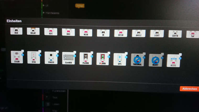

<p dir="auto"><img src="/assets/uploads/files/1588871781008-dsc_0002_burst20200507191101872-resized.jpg" alt="0_1588871681095_DSC_0002_BURST20200507191101872.JPG" class=" img-fluid img-markdown" /></p>
<p dir="auto">THERMAL and HEAT UNITS are the only ones that are greyed out in this version !</p>
<p dir="auto">You may have to install the software completely again !?</p>
<p dir="auto">greetings skink</p>
