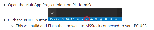

      • Click the BUILD button alt text
        --This will build and Flash the M5Stack connected to your PC USB

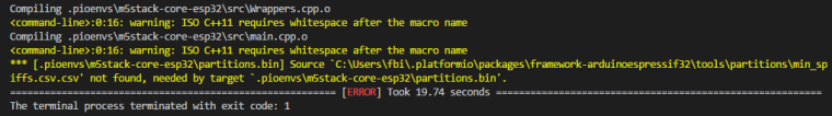

                        I download the new version https://github.com/botofancalin/M5Stack-MultiApp-Advanced
                        I apply the platformIO_Patch.
                        Open project and Build: -> Error missing file: Min_spiffs.csv.csv

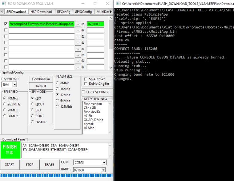

                        I try upload using the precompiled firmware.
                        Press Reset button after Finish but M5stack do nothing.

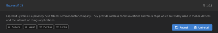

                          FreddyB @Calin
                          @calin
                          Yes, it works now.
                          I update the platform espressif 32 to version 1.0.1

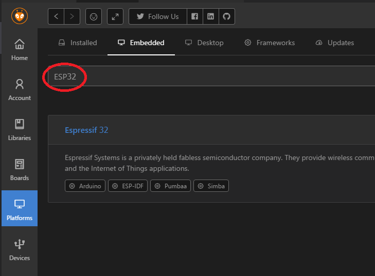

                            • C Offline
                              Calin @pkourany
                              @pkourany open VsCode PlatformIO
                              Go to Platforms.
                              Make sure you have Espressif 32 platform installed.
                              If not installed, go to Platforms-Enbedded and install it
                              To update the platform, go to Platforms-Updates If you see it there, then you can update. If not, then is up to date.
                              P 1 Reply Last reply Reply Quote 0
