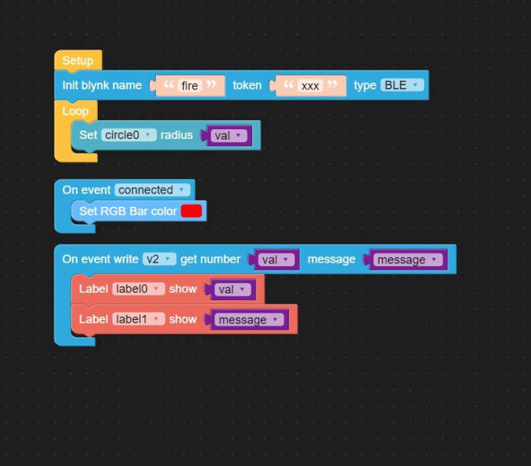

Here is a quick example<br />
<img src="/assets/uploads/files/1590202594116-example-resized.jpg" alt="0_1590202590446_example.jpg" class=" img-fluid img-markdown" /><br />
This code doesn't ever connect to blynk. Here is the code it generates:</p>
from m5ui import *
from uiflow import *
from ble import blynk
setScreenColor(0x222222)
label0 = M5TextBox(52, 10, "Text", lcd.FONT_Default,0xFFFFFF, rotate=0)
label1 = M5TextBox(46, 49, "Text", lcd.FONT_Default,0xFFFFFF, rotate=0)
circle0 = M5Circle(141, 122, 15, 0xFFFFFF, 0xFFFFFF)
val = None
message = None
blynk.init('fire', 'xxx', blynk.BLE)
while True:
  circle0.setSize(val)
  wait_ms(2)
@blynk.handle_event('connected')
def blynk_write():
  global val, message
  rgb.setColorAll(0xff0000)
  pass
@blynk.handle_event('write v2')
def blynk_write(*args):
  global val, message
  val, message = args[0], args[1]
  label0.setText(str(val))
  label1.setText(str(message))
  pass
</code></pre>
<p dir="auto">Here is the manually adjusted code that connects with blynk.</p>
from m5ui import *
val = None
message = None
def blynk_write():
  global val, message
  pass
  global val, message
  pass
while True:
  wait_ms(2)
</code></pre>

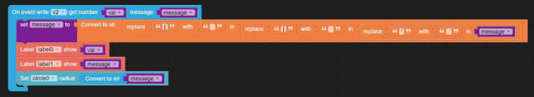

<p dir="auto">In the example above when the message variable is shown using label1.setText(str(message)) it shows the following ['255']. What is the most effective way in micropython to remove the [] and ' ' and convert message variable to an integer. I am using<br />
<img src="/assets/uploads/files/1590207034180-string-resized.jpg" alt="0_1590207030615_string.jpg" class=" img-fluid img-markdown" /><br />
which outputs this</p>
<pre><code>@blynk.handle_event('write v2')
  global val, message
  message = str(message.replace("'", '').replace(']', '').replace('[', ''))
  circle0.setSize(int(message))
  pass
</code></pre>
<p dir="auto">but should generate this</p>
  global val, message
  message = str(message).replace("'", '').replace(']', '').replace('[', '')
  pass</code></pre>

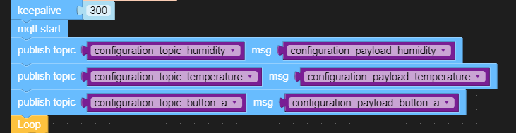

<img src="/assets/uploads/files/1589112492275-33a23857-2320-478c-b2cd-c3f040579572-image.png" alt="0_1589112489881_33a23857-2320-478c-b2cd-c3f040579572-image.png" class=" img-fluid img-markdown" /></p>
<p dir="auto">edit: sometimes first two. I have to change order for publish third configuration topic</p>
