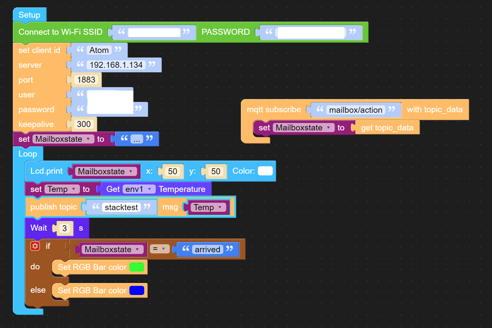

<p dir="auto">I'm new to m5stacks and uiFlow and hope someone could help me.</p>
<p dir="auto">I want my m5stack to subscribe to the MQTT Topic of my smart mailbox and react somehow when a letter was delivered. I use Mosquitto as my broker which is an addon to Home Assistant.</p>
<p dir="auto">As a quick test I did the following in uiFlow. I want the RGB turn green when the payload "arrived" is picked up in the topic "mailbox/action".<br />
<img src="/assets/uploads/files/1589066140581-f6044632-8412-4901-aa74-1bfc3b52c881-image-resized.png" alt="0_1589066138399_f6044632-8412-4901-aa74-1bfc3b52c881-image.png" class=" img-fluid img-markdown" /></p>

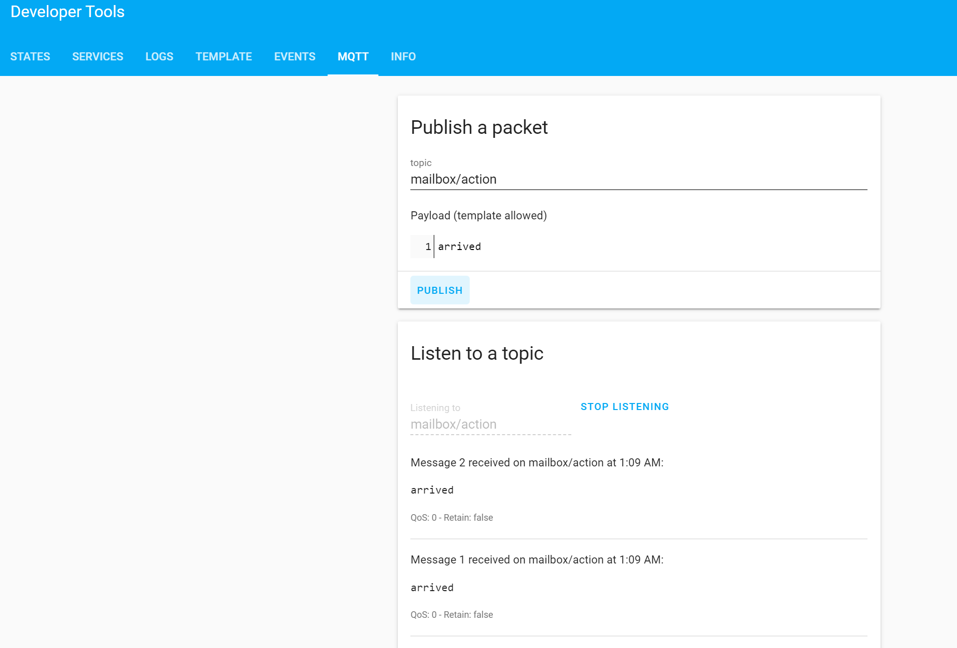

<p dir="auto">The publish part works fine, I can pick up the readings of the ENV Unit inside Home Assistant. What doesn't work is the subscribe part, i can't pick up anything with my m5stack. If i subscribe to to the topic inside Home Assistant to check it, it works.<br />
<img src="/assets/uploads/files/1589066215450-ccce12c5-c3d4-4b5f-aff5-4ac885359664-image-resized.png" alt="0_1589066213292_ccce12c5-c3d4-4b5f-aff5-4ac885359664-image.png" class=" img-fluid img-markdown" /></p>
<p dir="auto">Thanks for letting me know if there is some error in the code or you know what else could be wrong.</p>

Thank you very much, that fixed it!!! Many many thanks.</p>
]]></description><link>https://community.m5stack.com/post/8633</link><guid isPermaLink="true">https://community.m5stack.com/post/8633</guid><dc:creator><![CDATA[lederschnautz]]></dc:creator><pubDate>Mon, 11 May 2020 20:19:30 GMT</pubDate></item><item><title><![CDATA[Reply to Subscribing to MQTT doesn&#x27;t work on Mon, 11 May 2020 01:10:15 GMT]]></title><description><![CDATA[<p dir="auto">Looking at your flow again, I don’t see the “mqtt start” block. Drag that into your flow just below the MQTT connection details and hopefully that fixes it.</p>

<p dir="auto">Edit: never mind, now I see you published with mosquito in the second pic. I’m running the same setup, so let me do a test.</p>
]]></description><link>https://community.m5stack.com/post/8610</link><guid isPermaLink="true">https://community.m5stack.com/post/8610</guid><dc:creator><![CDATA[world101]]></dc:creator><pubDate>Sun, 10 May 2020 11:17:46 GMT</pubDate></item></channel></rss>
