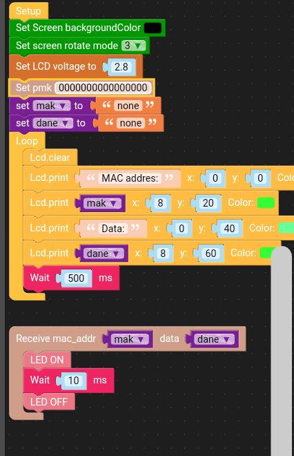

]]></description><link>https://community.m5stack.com/post/9757</link><guid isPermaLink="true">https://community.m5stack.com/post/9757</guid><dc:creator><![CDATA[paulmunday87]]></dc:creator><pubDate>Thu, 20 Aug 2020 02:32:21 GMT</pubDate></item><item><title><![CDATA[Reply to Esp now m5stickC problem on Sat, 06 Jun 2020 10:59:52 GMT]]></title><description><![CDATA[<p dir="auto"><a class="plugin-mentions-user plugin-mentions-a" href="/user/gianni" aria-label="Profile: gianni">@<bdi>gianni</bdi></a>, you can try below code. Maybe help you. The function receiving data, saves received data into variables and only the LED blinks. Short code with the least delays possible. And the correct reading of data from these variables and their processing takes place in the main loop of the program. I created it for fast debug esp-now transmission. Tested it with uiflow 1.4.5 web and 1.4.2 firmware on stickc</p>
<p dir="auto"><img src="/assets/uploads/files/1591440618216-screenshot_20200606-120611.jpg" alt="0_1591440613587_Screenshot_20200606-120611.jpg" class=" img-fluid img-markdown" /></p>

]]></description><link>https://community.m5stack.com/post/8913</link><guid isPermaLink="true">https://community.m5stack.com/post/8913</guid><dc:creator><![CDATA[robalstona]]></dc:creator><pubDate>Sat, 06 Jun 2020 10:59:52 GMT</pubDate></item><item><title><![CDATA[Reply to Esp now m5stickC problem on Fri, 05 Jun 2020 23:07:49 GMT]]></title><description><![CDATA[<p dir="auto"><a class="plugin-mentions-user plugin-mentions-a" href="/user/devilstower" aria-label="Profile: Devilstower">@<bdi>Devilstower</bdi></a> i downloaded the code but it didn't work. anyway I tried to remove the code from the "receive" and it seems to work .. but i don't understand the reason :(</p>
