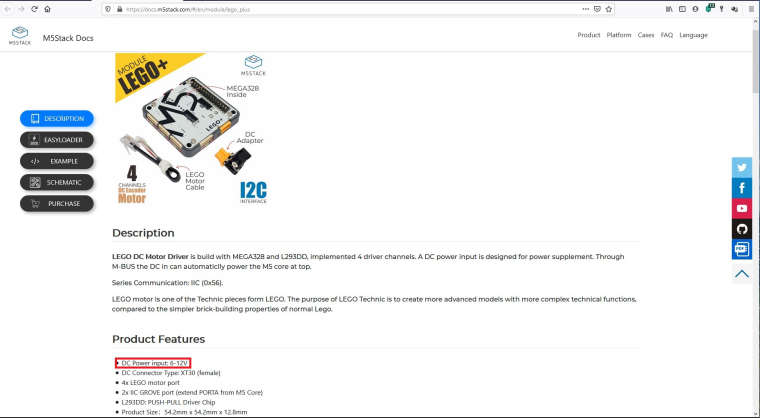

<p dir="auto">Hello all,<br />
I would like to connect (old) Lego PowerFunctions motors to the LEGO+ module.  There are a few things I need to solve for this.  But if anyone has already done so, perhaps I can save some time.  I will write up a detailed step-by-step once I get it to work.</p>
<p dir="auto">The PowerFunctions motors are 9V.  I see that the LEGO+ module can take external power input (the yellow XT30 connector) with a nice wide range of voltages, but I also see that the pins on the ports are labeled "5V" (<a href="https://docs.m5stack.com/#/en/module/lego_plus" target="_blank" rel="noopener noreferrer nofollow ugc">https://docs.m5stack.com/#/en/module/lego_plus</a>).  Does anyone know whether the input power Vcc is passed directly to the motor connectors?  I also read that the voltage on this external input is passed directly (i.e., unregulated) on to the M5Core itself; is it safe to put 9V on this input?</p>
<p dir="auto">The module came with a connector cable to an EV3 "telephone type" connector.  I have found descriptions of the LPF2 connectors, so I can just buy connector cables from Lego themselves (they're only a few euros each) and cut them up to make compatible connectors.  I found "compatibility cables" online, but they are not the correct PowerFunctions type.</p>
<p dir="auto">Did anyone here try this before?  I found a YouTube video of someone who connected a PowerFunctions motor to an M5Stack, but it was just 30 seconds of a motor spinning and no details about the connection itself...<br />
