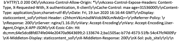

<p dir="auto">Sample of the response bodies:</p>
<p dir="auto">Most common and working</p>
<p dir="auto"><img src="/assets/uploads/files/1592586746683-94870666-555a-4b5b-b9f4-d3075d8db6f9-image.png" alt="0_1592586738340_94870666-555a-4b5b-b9f4-d3075d8db6f9-image.png" class=" img-fluid img-markdown" /><br />
See its use all the time \r\n</p>
<p dir="auto">GoPro sample, and not working</p>
<p dir="auto"><img src="/assets/uploads/files/1592586694296-56dcbd62-936d-4bdc-a48c-f6abac19cfb3-image.png" alt="0_1592586692165_56dcbd62-936d-4bdc-a48c-f6abac19cfb3-image.png" class=" img-fluid img-markdown" /><br />
See it ends with \n\n b'HTTP/1.0 200 OK\r\n</p>
