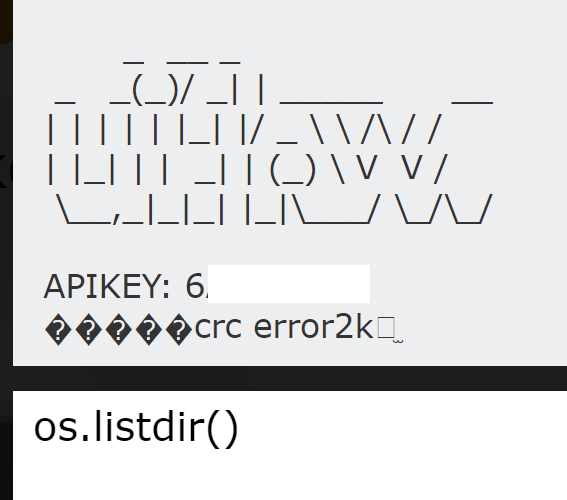

M5Burner Beta com monitor doesn't work. The pymakr console extension to VSCode doesn't work. They all seem to get stuck at:</p>
<pre><code>AutoConnect enabled, ignoring 'address' setting (see Global Settings)
Searching for PyCom boards on serial...
Connecting to COM7...
       _  __ _
 _   _(_)/ _| | _____      __
| | | | | |_| |/ _ \ \ /\ / /
| |_| | |  _| | (_) \ V  V /
 \__,_|_|_| |_|\___/ \_/\_/
APIKEY: 6&lt;numbers&gt;
</code></pre>

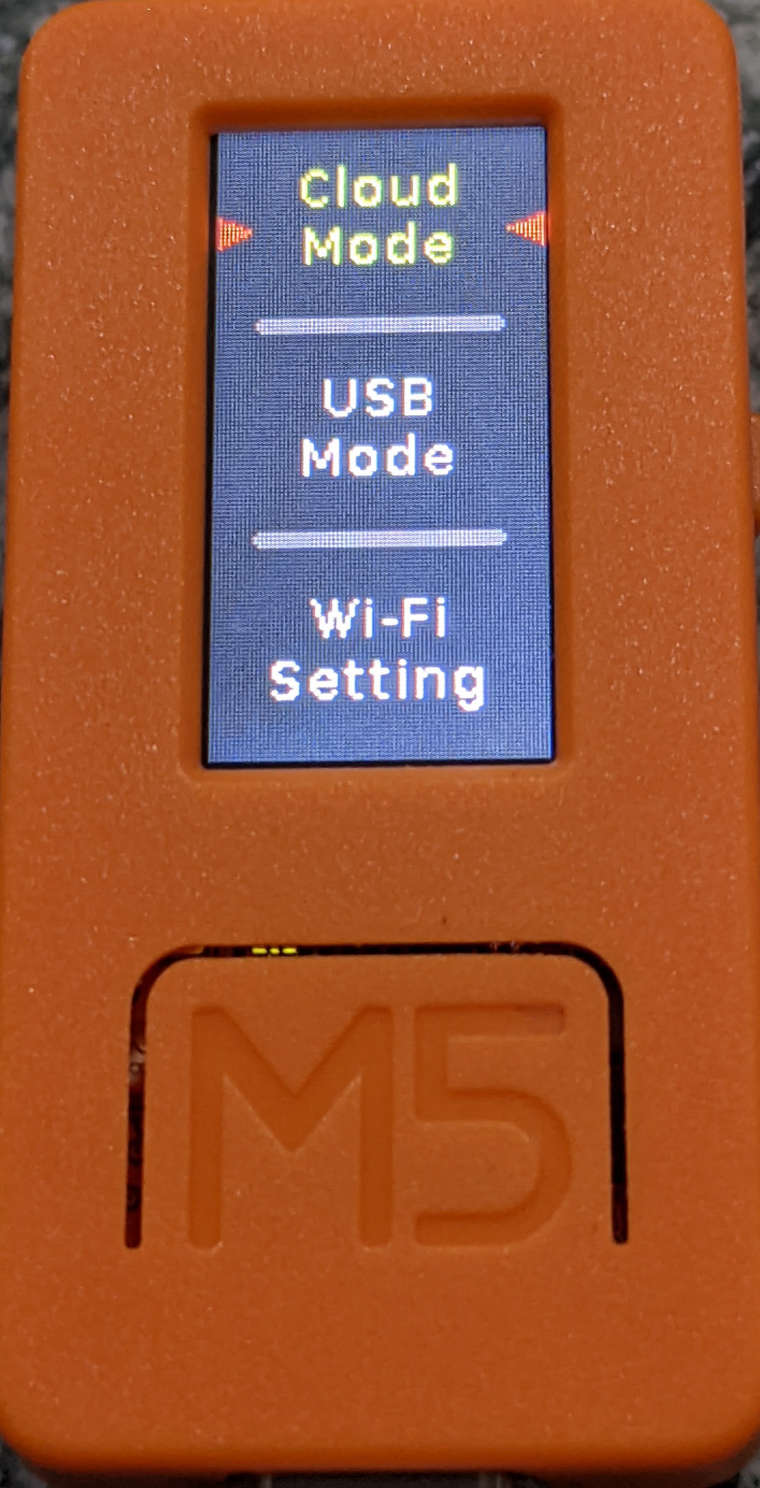

It is really hard to hit the button fast enough, <em>particularly</em> if I have had to "hold down A and press power" to reboot! Can we have an option back in settings as well?</p>
]]></description><link>https://community.m5stack.com/post/9133</link><guid isPermaLink="true">https://community.m5stack.com/post/9133</guid><dc:creator><![CDATA[dclaar]]></dc:creator><pubDate>Wed, 24 Jun 2020 15:05:46 GMT</pubDate></item><item><title><![CDATA[Reply to When are we going to get new Firmware? on Wed, 24 Jun 2020 05:46:04 GMT]]></title><description><![CDATA[<p dir="auto">M5StickC 1.5 setup USB mode operation has some different.</p>
<p dir="auto">turn on the device.  when you see the logo, you need click right side button quickly to select mode.</p>
<p dir="auto">you could refer this turtorial to learn other operation.</p>
<p dir="auto"><a href="https://docs.m5stack.com/#/en/quick_start/m5stickc/m5stickc_quick_start_with_uiflow" target="_blank" rel="noopener noreferrer nofollow ugc">https://docs.m5stack.com/#/en/quick_start/m5stickc/m5stickc_quick_start_with_uiflow</a></p>

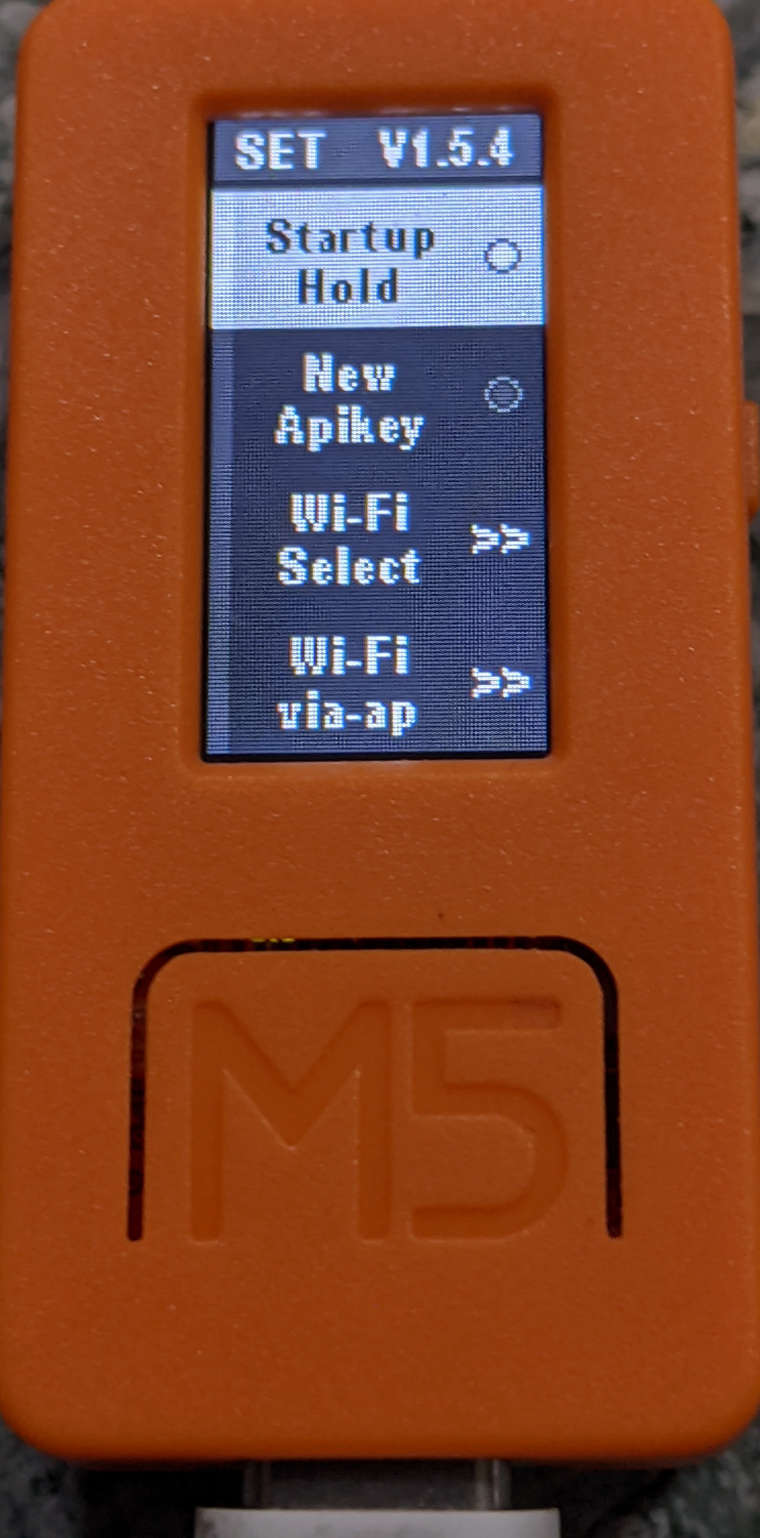

With 1.5.4, Settings doesn't show a USB mode, just<br />
Startup hold (which seems to do nothing), New Apikey, Wi-Fi Select, WiFi via-ap, and Reboot.<img src="/assets/uploads/files/1592970685981-pxl_20200624_034816527-resized.jpg" alt="0_1592970686338_PXL_20200624_034816527.jpg" class=" img-fluid img-markdown" /></p>
<p dir="auto">Also, I was unable to go back to 1.4.5.1 with the new firmware burner: It says that the firmware is too big. The old burner does just fine however. I did erase between.</p>
