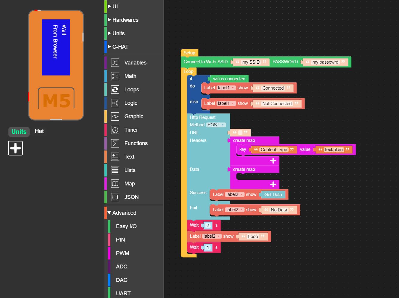

<?xml version="1.0" encoding="UTF-8"?><rss xmlns:dc="http://purl.org/dc/elements/1.1/" xmlns:content="http://purl.org/rss/1.0/modules/content/" xmlns:atom="http://www.w3.org/2005/Atom" version="2.0"><channel><title><![CDATA[M5 Stick C - receiving data over WIFI]]></title><description><![CDATA[<p dir="auto">I am trying to send simple data from my Laptop to display on my Stick C Screen.<br />
I am pretty sure the WIFI is connected but can find very little in the way of examples or tutorials.<br />
I can ping my Stick C, but it refuses a connection when I send data to it using Restman POST utility<br />
I am not sure if I should be using the HTTP block or something else.<br />
I want to use blockly rather than Python so I can teach my Kids once I have figured it out.<br />
Please can someone look at this and tell me what I am doing wrong.</p>
<p dir="auto">Thanks</p>
<p dir="auto"><img src="/assets/uploads/files/1593072274157-m5stack-resized.jpg" alt="0_1593072273557_m5stack.JPG" class=" img-fluid img-markdown" /> image url)</p>

]]></description><link>https://community.m5stack.com/post/9193</link><guid isPermaLink="true">https://community.m5stack.com/post/9193</guid><dc:creator><![CDATA[Neil]]></dc:creator><pubDate>Mon, 29 Jun 2020 09:12:18 GMT</pubDate></item><item><title><![CDATA[Reply to M5 Stick C - receiving data over WIFI on Sat, 27 Jun 2020 20:28:58 GMT]]></title><description><![CDATA[<p dir="auto">The http block you are using is for talking to a web site, not for <strong>being</strong> a web site. Or in more technical terms, it is a client, not a server. If you had a web server on your laptop, it could talk to that.</p>
<p dir="auto">Looking at the other options, it looks like <a href="https://www.espressif.com/en/products/software/esp-now/overview" target="_blank" rel="noopener noreferrer nofollow ugc">EspNow</a> can listen for data, but I don't know if there's a laptop client.</p>
<p dir="auto"><a href="https://github.com/m5stack/m5-docs/blob/master/docs/en/uiflow/advanced.md#mqtt-communication" target="_blank" rel="noopener noreferrer nofollow ugc">mqtt</a> is a client that needs a cloud-based server.</p>
<p dir="auto">There's a <a href="https://github.com/m5stack/m5-docs/blob/master/docs/en/uiflow/advanced.md#P2P" target="_blank" rel="noopener noreferrer nofollow ugc">p2p</a> option under network, but that seems to be for talking between 2 devices.</p>
<p dir="auto">Finally, there's <a href="https://github.com/m5stack/m5-docs/blob/master/docs/en/uiflow/advanced.md#remote" target="_blank" rel="noopener noreferrer nofollow ugc">remote</a>, which it says "Remote control M5Stack via devices such as mobile phone or computer." I think that's your best bet.</p>
