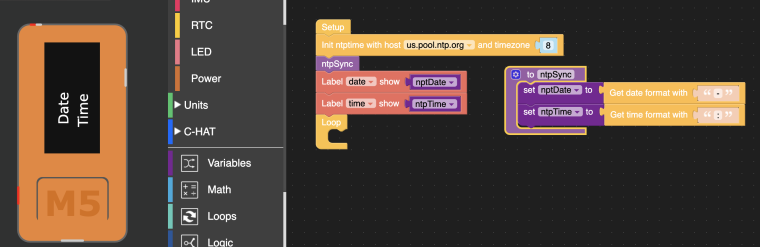

<p dir="auto">Edit #1: it seems like NTP isn't working for me on the StickC with a very basic flow...</p>
<p dir="auto"><img src="/assets/uploads/files/1595605449337-screen-shot-2020-07-24-at-11.43.38-am-resized.png" alt="0_1595605440771_Screen Shot 2020-07-24 at 11.43.38 AM.png" class=" img-fluid img-markdown" /></p>
<p dir="auto">The REPL error:</p>
<pre><code>Traceback (most recent call last):
  File "flow/m5cloud.py", line 76, in _exec_fun
  File "&lt;string&gt;", line 23, in &lt;module&gt;
NameError: name 'ntptime' isn't dUnhandled eefined
xception in thread started by &lt;bound_method&gt;
  File "flow/m5cloud.py", line 120, in _msg_deal_task
AttributeError: 'M5TextBox' object has no attribute 'ticks_ms'
</code></pre>
<hr />
<p dir="auto">Edit #2 -- workaround:<br />
I think the <strong>Init nttptime with host</strong> block needs to call "import ntptime" first. I fixed it by adding an execute block before the init. NTP works now.<br />
<img src="/assets/uploads/files/1595611155100-screen-shot-2020-07-24-at-1.18.47-pm-resized.png" alt="0_1595611150435_Screen Shot 2020-07-24 at 1.18.47 PM.png" class=" img-fluid img-markdown" /></p>
