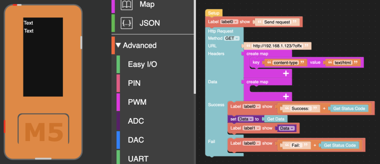

]]></description><link>https://community.m5stack.com/post/9560</link><guid isPermaLink="true">https://community.m5stack.com/post/9560</guid><dc:creator><![CDATA[robalstona]]></dc:creator><pubDate>Sat, 01 Aug 2020 17:47:32 GMT</pubDate></item><item><title><![CDATA[Reply to HttpPost using UIflow on Sat, 01 Aug 2020 13:46:59 GMT]]></title><description><![CDATA[<p dir="auto"><a class="plugin-mentions-user plugin-mentions-a" href="/user/franco" aria-label="Profile: franco">@<bdi>franco</bdi></a> what is the m5stack device is talking to?  It appears to be a web server or similar, but what is it?  Also, I would recommend adding another label to the m5stack/m5stickC to get the HTTP status code. This would give an indication if the flow is timing out (no response or eventually failure after the timeout period) or what the response is with the HTTP error code (see <a href="https://www.restapitutorial.com/httpstatuscodes.html" target="_blank" rel="noopener noreferrer nofollow ugc">this link</a> for a list of error codes).</p>
<p dir="auto"><img src="/assets/uploads/files/1596285060264-screen-shot-2020-08-01-at-8.30.37-am-resized.png" alt="0_1596285055868_Screen Shot 2020-08-01 at 8.30.37 AM.png" class=" img-fluid img-markdown" /></p>
<p dir="auto">Also, you showed two http addresses above, <a href="http://79.8.125.79:8084/?onx" target="_blank" rel="noopener noreferrer nofollow ugc">http://79.8.125.79:8084/?onx</a> and <a href="http://192.168.1.123/?offx" target="_blank" rel="noopener noreferrer nofollow ugc">http://192.168.1.123/?offx</a>. I assume one is on a public network and the other is on your private/local network. So you would also need to make sure the servers are not blocking traffic from the network the m5stack/m5stickC is on.</p>

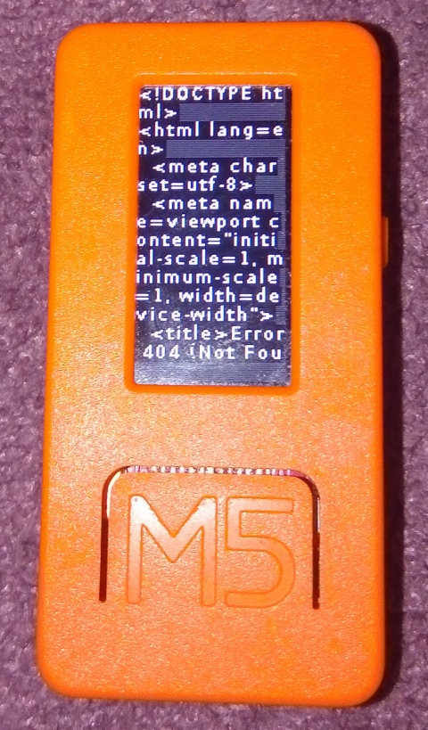

<p dir="auto">I change adress to:<strong><a href="https://www.google.com/index.html" target="_blank" rel="noopener noreferrer nofollow ugc">https://www.google.com/index.html</a></strong> and i getback this response. I receive error, but show the server response for this request</p>
<p dir="auto"><img src="/assets/uploads/files/1596271765102-img_20200801_103725-01.jpg" alt="0_1596271685936_IMG_20200801_103725-01.jpg" class=" img-fluid img-markdown" /></p>

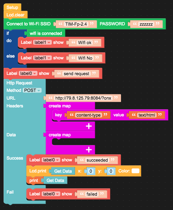

"Get data" fail.<br />
<img src="/assets/uploads/files/1595874003434-schermata-2020-07-27-alle-20.18.54.png" alt="0_1595873974367_Schermata 2020-07-27 alle 20.18.54.png" class=" img-fluid img-markdown" /></p>

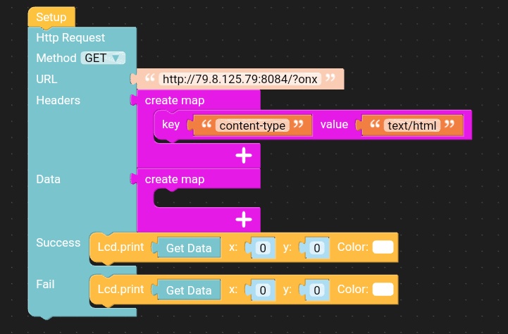

<p dir="auto"><img src="/assets/uploads/files/1595860951956-screenshot_20200727-163409-01-resized.jpeg" alt="0_1595860935159_Screenshot_20200727-163409-01.jpeg" class=" img-fluid img-markdown" /></p>
<p dir="auto"><img src="/assets/uploads/files/1595861021210-screenshot_20200727-163429-01-resized.jpeg" alt="0_1595860973942_Screenshot_20200727-163429-01.jpeg" class=" img-fluid img-markdown" /></p>

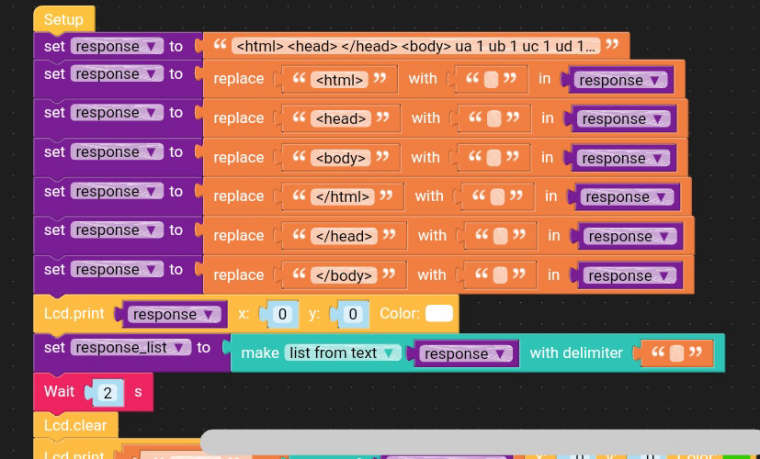

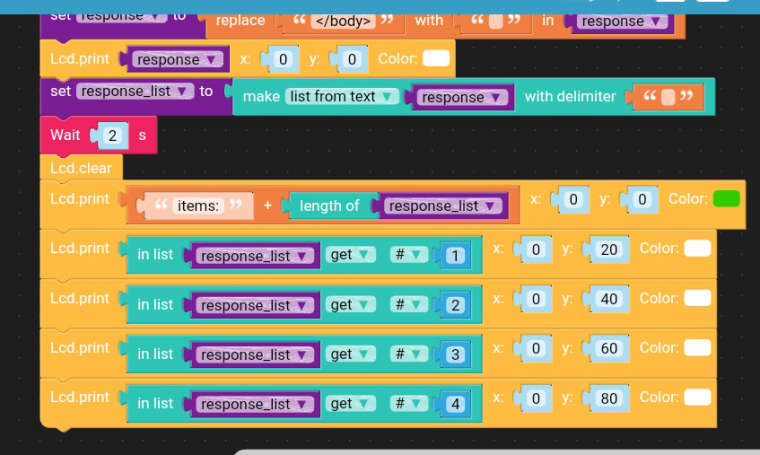

]]></description><link>https://community.m5stack.com/post/9460</link><guid isPermaLink="true">https://community.m5stack.com/post/9460</guid><dc:creator><![CDATA[franco]]></dc:creator><pubDate>Mon, 27 Jul 2020 13:12:10 GMT</pubDate></item><item><title><![CDATA[Reply to HttpPost using UIflow on Mon, 27 Jul 2020 12:28:43 GMT]]></title><description><![CDATA[<p dir="auto">You should write a own parser for this response.</p>
<p dir="auto">You could use a block:<br />
text-&gt;replace <strong>oldvalue</strong> with <strong>newvalue</strong> in  <strong>yourresponse</strong><br />
to remove uneccessary values from your response</p>
<p dir="auto">where as:<br />
<strong>oldvalue</strong> you assign "&lt;HTML&gt;"<br />
<strong>newwalue</strong> you assign "" (empty string)<br />
<strong>yourresponse</strong> assign your response variable</p>
<p dir="auto">And repeat this for all other html markups exists  in your response. When you have only interested values<br />
<strong>ua 1 ub 1 ... ul 1</strong><br />
when you could use: list -&gt; make list from text <strong>yourresponse</strong> with delimiter <strong>" "</strong></p>
