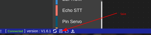

<img src="/assets/uploads/files/1596091291510-9be11031-2f0f-4042-b672-efb18919355f-image.png" alt="0_1596091291450_9be11031-2f0f-4042-b672-efb18919355f-image.png" class=" img-fluid img-markdown" /></p>
]]></description><link>https://community.m5stack.com/post/9502</link><guid isPermaLink="true">https://community.m5stack.com/post/9502</guid><dc:creator><![CDATA[IAMLIUBO]]></dc:creator><pubDate>Thu, 30 Jul 2020 06:42:16 GMT</pubDate></item><item><title><![CDATA[Reply to ESP NOW send not working in 1.6.1 on Thu, 30 Jul 2020 05:44:37 GMT]]></title><description><![CDATA[<p dir="auto"><a class="plugin-mentions-user plugin-mentions-a" href="/user/iamliubo" aria-label="Profile: iamliubo">@<bdi>iamliubo</bdi></a></p>

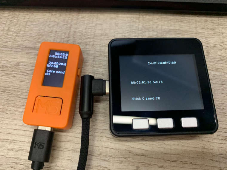

<p dir="auto">I just test it with StickC and Core basic,It work well in firmware V1.6.1.Can you show your "blocks" with us?</p>
<p dir="auto"><img src="/assets/uploads/files/1596072050689-espnow-test-resized.jpg" alt="0_1596072050293_ESPnow-test.jpg" class=" img-fluid img-markdown" /></p>
