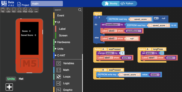

For uiFlow, there is an example of saving data as a key/value pair in <a href="https://docs.m5stack.com/#/en/uiflow/advanced?id=eeprom" target="_blank" rel="noopener noreferrer nofollow ugc">M5 Docs</a>.</p>
<p dir="auto">I also created a simple example like this...<br />
<img src="/assets/uploads/files/1598705692672-screen-shot-2020-08-29-at-8.52.51-am-resized.png" alt="0_1598705685410_Screen Shot 2020-08-29 at 8.52.51 AM.png" class=" img-fluid img-markdown" /></p>
