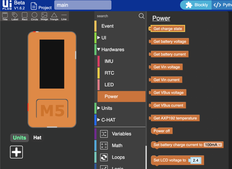

<?xml version="1.0" encoding="UTF-8"?><rss xmlns:dc="http://purl.org/dc/elements/1.1/" xmlns:content="http://purl.org/rss/1.0/modules/content/" xmlns:atom="http://www.w3.org/2005/Atom" version="2.0"><channel><title><![CDATA[Detect charging on M5StickC?]]></title><description><![CDATA[<p dir="auto">Is there a way in software to detect if the M5StickC is charging or running on battery? I'm assuming the power management unit (AXP192) must know, but is that information exposed somewhere?</p>
<p dir="auto">Thanks!</p>
]]></description><link>https://community.m5stack.com/topic/2258/detect-charging-on-m5stickc</link><generator>RSS for Node</generator><lastBuildDate>Sat, 02 May 2026 18:50:24 GMT</lastBuildDate><atom:link href="https://community.m5stack.com/topic/2258.rss" rel="self" type="application/rss+xml"/><pubDate>Mon, 31 Aug 2020 17:45:03 GMT</pubDate><ttl>60</ttl><item><title><![CDATA[Reply to Detect charging on M5StickC? on Mon, 31 Aug 2020 18:12:41 GMT]]></title><description><![CDATA[<p dir="auto"><a class="plugin-mentions-user plugin-mentions-a" href="/user/sbussinger" aria-label="Profile: sbussinger">@<bdi>sbussinger</bdi></a></p>
<p dir="auto">Yes. With uiFlow:<br />
<img src="/assets/uploads/files/1598897437459-screen-shot-2020-08-31-at-2.01.03-pm-resized.png" alt="0_1598897389116_Screen Shot 2020-08-31 at 2.01.03 PM.png" class=" img-fluid img-markdown" /></p>
<p dir="auto">Or Arduino:<br />
<a href="https://docs.m5stack.com/#/en/api/axp192_m5stickc" target="_blank" rel="noopener noreferrer nofollow ugc">https://docs.m5stack.com/#/en/api/axp192_m5stickc</a><br />
<a href="https://github.com/m5stack/M5StickC/blob/master/examples/Basics/AXP192/AXP192.ino" target="_blank" rel="noopener noreferrer nofollow ugc">https://github.com/m5stack/M5StickC/blob/master/examples/Basics/AXP192/AXP192.ino</a></p>
