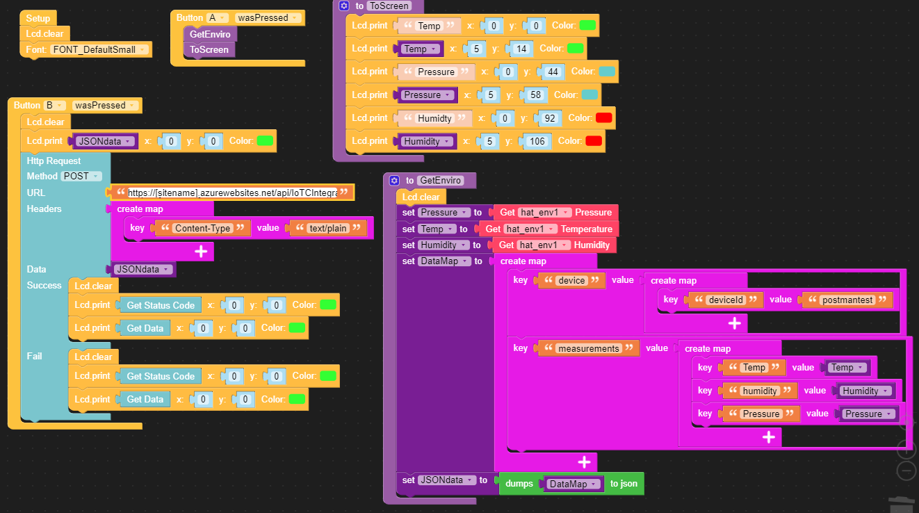

<p dir="auto">I just want to replicate this simple HTTP Post with JSON data payload in a UIFlow. I can then use my m5Stickc to send the real data.</p>
<p dir="auto">Here is my attempt:<br />
<img src="/assets/uploads/files/1599182445191-93903347-5378-4580-978d-f0afe6a2db11-image-resized.png" alt="0_1599182443317_93903347-5378-4580-978d-f0afe6a2db11-image.png" class=" img-fluid img-markdown" /></p>
<p dir="auto">I have tried many variations of the 'data' payload   - sometimes I get 400 errors - sometimes I get responses to say the 'device' is not correctly specified - but most of my attempts I get no response back.</p>
<p dir="auto">What would be the best way to recreate the POST command in UIFlow?</p>
<p dir="auto">Im - close  - so thanks anybody that can help :)</p>

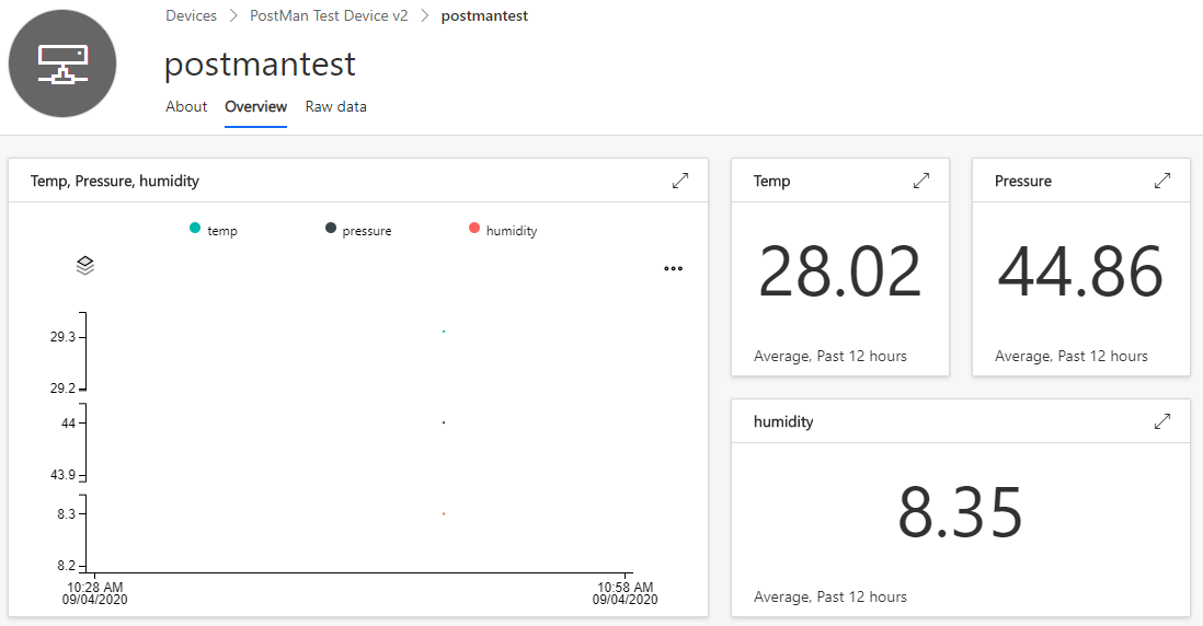

<p dir="auto">Anyway - progress! Here is the nice little graph of 'realworld' data from the m5stick in a dashboard in Azure IoT  - thanks for your help.<br />
<img src="/assets/uploads/files/1599287352207-e3922b1d-0018-4bad-9342-8c2444f1dd5a-image-resized.png" alt="0_1599287350659_e3922b1d-0018-4bad-9342-8c2444f1dd5a-image.png" class=" img-fluid img-markdown" /></p>

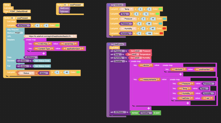

<p dir="auto">I think your DataMap and JSONdata payload looks good and is formatted correctly. Here is a slightly modified flow that has a few tweaks to set the content-type to JSON (since you are posting JSON data) and to remove the "get data" from the success/fail on HTTP request. I don't think you need that since you are doing HTTP POST and not GET. Plus you are already printing the JSONdata to the screen just before the HTTP Request.</p>
<p dir="auto"><img src="/assets/uploads/files/1599233540050-screen-shot-2020-09-04-at-11.22.59-am-resized.png" alt="0_1599233508721_Screen Shot 2020-09-04 at 11.22.59 AM.png" class=" img-fluid img-markdown" /></p>
<p dir="auto">Since I'm not an Azure IoT user, I used an Adafruit IO Webhook to verify the flow operates correctly to get data to the cloud.  I get a status code 200 (HTTP OK) with the flow above. I also had to add a header with my AIO secret key, so you might need to do the same with the Azure "code" secret key. Please verify that with the Azure IoT API documentation. Give it a try and see how it goes. If it gives something other than HTTP 200 for the status, let us know what the error code is so we can troubleshoot further.</p>
<p dir="auto">Also, I have noticed before if I try to do too much logic in the success/fail sections of the HTTP Request block, strange things can happen. So I like to keep it simple and just capture the status code to a variable and then print it after the HTTP Request has finished.</p>
]]></description><link>https://community.m5stack.com/post/9944</link><guid isPermaLink="true">https://community.m5stack.com/post/9944</guid><dc:creator><![CDATA[world101]]></dc:creator><pubDate>Fri, 04 Sep 2020 15:32:36 GMT</pubDate></item><item><title><![CDATA[Reply to HTTP POST to Azure IoT on Fri, 04 Sep 2020 10:51:11 GMT]]></title><description><![CDATA[<p dir="auto">You could try a create manual string in json format something like that (incomplete example)</p>

]]></description><link>https://community.m5stack.com/post/9941</link><guid isPermaLink="true">https://community.m5stack.com/post/9941</guid><dc:creator><![CDATA[robalstona]]></dc:creator><pubDate>Fri, 04 Sep 2020 10:51:11 GMT</pubDate></item><item><title><![CDATA[Reply to HTTP POST to Azure IoT on Fri, 04 Sep 2020 04:55:58 GMT]]></title><description><![CDATA[<p dir="auto">In simple terms without all the story, how do you do a HTML Post with this data?</p>
