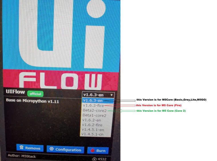

<p dir="auto">Here is a breakdown of the versions for the respective M5 Core's<br />
<img src="/assets/uploads/files/1600509635869-uiflow-resized.jpg" alt="0_1600509596932_UIFlow.jpg" class=" img-fluid img-markdown" /></p>
<p dir="auto">what I don't know exactly is if M5 Core Lite and M5GO are not also part of M5Core Fire.</p>
]]></description><link>https://community.m5stack.com/post/10132</link><guid isPermaLink="true">https://community.m5stack.com/post/10132</guid><dc:creator><![CDATA[Skink]]></dc:creator><pubDate>Sat, 19 Sep 2020 10:01:45 GMT</pubDate></item><item><title><![CDATA[Reply to UIFlow 1.6.3 on Thu, 17 Sep 2020 18:14:41 GMT]]></title><description><![CDATA[<p dir="auto"><a class="plugin-mentions-user plugin-mentions-a" href="/user/ajb2k3" aria-label="Profile: ajb2k3">@<bdi>ajb2k3</bdi></a></p>

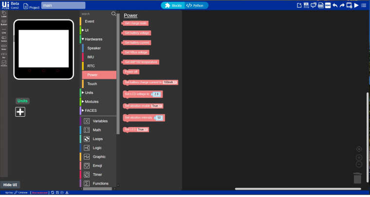

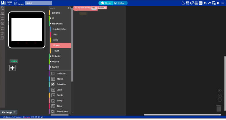

<p dir="auto">Ah, that seems to be a problem in the language German in the English everything works.</p>
<ol>
<li>picture Core 2 Language "English</li>
<li>picture Core 2 Language "German"</li>
</ol>
<p dir="auto"><img src="/assets/uploads/files/1599934322704-englisch-resized.jpg" alt="0_1599934313555_Englisch.jpg" class=" img-fluid img-markdown" /></p>
<p dir="auto"><img src="/assets/uploads/files/1599934360058-deutsche-resized.jpg" alt="0_1599934352794_Deutsche.jpg" class=" img-fluid img-markdown" /></p>
<p dir="auto">In the English version I have several options under Hardware Power which I can select.</p>
<p dir="auto">In the german version these are missing and the two that are displayed are on top of each other and cannot be selected !!</p>
