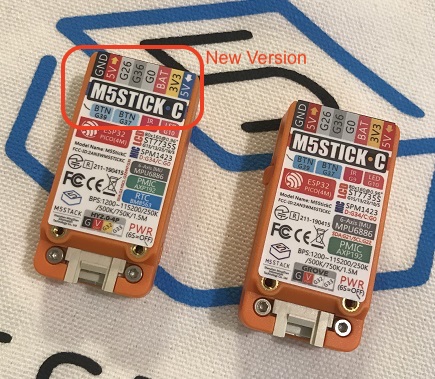

<p dir="auto">I wouldn’t assume a change in the sticker also represents a change in hardware. For example, I have the initial release of the M5StickC (no copper nuts, which are actually copper mounting screw holes), red 5V IN on the sticker, and no “RTC” label on the sticker. However, my device actually has a functional RTC inside. So adding the RTC label on the sticker doesn’t mean they revisioned the hardware and added the RTC. It was always there.</p>
<p dir="auto">I also cannot assume that the M5stack documentation is accurate 🤣. I think they make little revisions over time and don’t always communicate or document what was done.</p>

<p dir="auto">hmm, the two stickers in your picture and mine are all different, yet all three devices already have the copper nuts, which according to that list have been added only in the second last version. This would mean only two version with copper nuts should exist...</p>
<p dir="auto">Cheers<br />

<p dir="auto"><a class="plugin-mentions-user plugin-mentions-a" href="/user/world101" aria-label="Profile: world101">@<bdi>world101</bdi></a> Interesting that there are different stickers. The sticker on mine mentions the RTC (like the left one on your picture) but the 5V label is still red. Maybe a version in between?</p>
Felix</p>
<p dir="auto">Yep there are 4 different versions documented <a href="https://docs.m5stack.com/#/en/core/m5stickc?id=version-change" target="_blank" rel="noopener noreferrer nofollow ugc">here</a>.</p>

<p dir="auto">This has been fixed, as long has you have the newer version of the M5StickC (the one with the blue 5V In sticker at the top header).<br />
<img src="/assets/uploads/files/1600089168633-m5stickc_new_version.jpg" alt="0_1600089164498_m5stickC_new_version.jpg" class=" img-fluid img-markdown" /></p>
