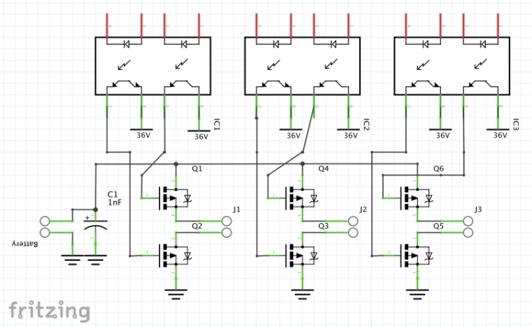

<p dir="auto">The Prototype modular duel motor controller,<br />
<img src="/assets/uploads/files/1529263543309-fritzmotopto-resized.png" alt="0_1529263541906_Fritzmotopto.png" class=" img-fluid img-markdown" /></p>
<p dir="auto">The idea was to use Opto isolators to separate the controller from the mosfet drivers.<br />
The diagram is currently set as a 3 stage "Brused" motor however, by shorting the 2 pins of J1, J2, and J3 together you can use the same hardware to drive a "Brushless" motor.<br />
Not shown are the 3x10amp fuses that should be between the mosfets and the 36v power rail.<br />
I'm doing this way because the old driver used 1 unfused mosfet and constantly burns out FQA160N08 mostfets!<br />
I have a feeling that the motor may be on its way out but the old speed controller was failing and didn't react to the brake cutout signal.</p>
<p dir="auto">Driving brushed or brushless motors with high loads is not that easy...<br />
First of all: the fuse is useless on transistors. The transistors will blow up way faster then the fuse can react.<br />
Second: for high load applications, like an e-bike, you need to consider some kind of current control for the motors (brushed or brushless) so you can achieve about the same speed, no matter the load.</p>
<p dir="auto">Consider using some hobby helicopter or boat ESC controllers for driving the motors.<br />
They are reliable, mature products with lots of motor driving related features builtin (soft start, constant RPM control, braking, etc...) and they can provide 5V power supply for ESP32.<br />
They are easy to control using simple PWM signals and they have builtin protections.</p>
<p dir="auto">Here are some examples:<br />
<img src="http://www.integy.com/C24447.jpg" alt="alt text" class=" img-fluid img-markdown" /><br />
or<br />
<img src="https://ae01.alicdn.com/kf/HTB1fiCuIXXXXXXaXXXXq6xXFXXXO/HOBBYWING-EZRUN-PRO-Brushless-Motor-150A-ESC-1-8-SL563.jpg_640x640.jpg" alt="alt text" class=" img-fluid img-markdown" /></p>
<p dir="auto">I'v been playing with this kind of controllers about 10 years ago and i can assure you there is some serious research work behind them...</p>
