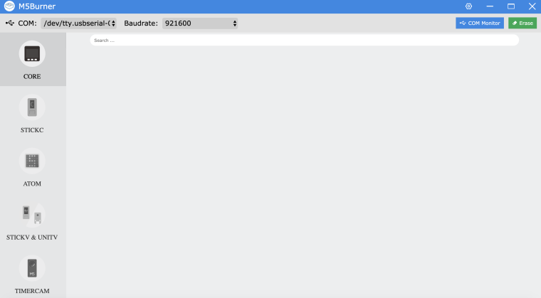

Today tried to use M5Burner on my Mac osx Catalina 10.15.6. M5Burner starts, shows a screen but this doesn't resemble the screenshots on any forum or tutorial and I can not select a firmware to flash.<br />

]]></description><link>https://community.m5stack.com/topic/2396/uiflow-on-core-2</link><generator>RSS for Node</generator><lastBuildDate>Wed, 29 Apr 2026 16:17:42 GMT</lastBuildDate><atom:link href="https://community.m5stack.com/topic/2396.rss" rel="self" type="application/rss+xml"/><pubDate>Tue, 20 Oct 2020 16:41:33 GMT</pubDate><ttl>60</ttl><item><title><![CDATA[Reply to UIFlow on core 2 on Wed, 28 Oct 2020 03:05:46 GMT]]></title><description><![CDATA[<p dir="auto">MacOS users please put M5Burner App in the Application folder after the installation as shown in the figure below.</p>

<p dir="auto">Maybe M5Stack can add the information why it has to be in the Applications folder.</p>
<pre><code>Please move this app into Applications directory.
Otherwise the firmware images can not be loaded.
</code></pre>

]]></description><link>https://community.m5stack.com/post/10422</link><guid isPermaLink="true">https://community.m5stack.com/post/10422</guid><dc:creator><![CDATA[gerbenheinen]]></dc:creator><pubDate>Wed, 21 Oct 2020 16:42:50 GMT</pubDate></item><item><title><![CDATA[Reply to UIFlow on core 2 on Wed, 21 Oct 2020 10:58:22 GMT]]></title><description><![CDATA[<p dir="auto">Is it the M5Burner has been put in <code>Applications</code> directory?</p>

<p dir="auto"><img src="/assets/uploads/files/1603276809434-schermafbeelding-2020-10-21-om-12.39.14-resized.png" alt="0_1603276771096_Schermafbeelding 2020-10-21 om 12.39.14.png" class=" img-fluid img-markdown" /></p>

]]></description><link>https://community.m5stack.com/post/10415</link><guid isPermaLink="true">https://community.m5stack.com/post/10415</guid><dc:creator><![CDATA[m5stack]]></dc:creator><pubDate>Wed, 21 Oct 2020 09:57:47 GMT</pubDate></item><item><title><![CDATA[Reply to UIFlow on core 2 on Wed, 21 Oct 2020 05:23:56 GMT]]></title><description><![CDATA[<p dir="auto">What do you mean "this doesn't resemble the screenshots on any forum or tutorial"</p>
