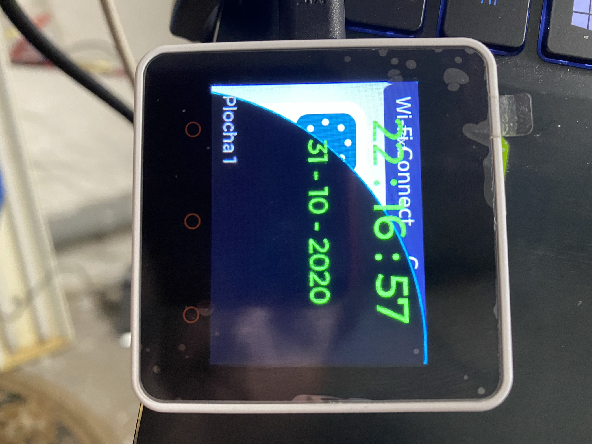

<p dir="auto">I just got M5stack core2, and  I have a problem that when in UIFlow I create a program to connect to wifi and afterwards show any data. Wi-fi connect "screen" is shown on background even if I do clear lcd and set-background</p>
<p dir="auto">also I tried to create full screen label on layer 3 and it was OK.<br />
<img src="/assets/uploads/files/1604179628978-img_3300-resized.jpeg" alt="0_1604179625000_IMG_3300.JPEG" class=" img-fluid img-markdown" /></p>
<p dir="auto">Please do you have any idea what I am doing wrong?</p>
]]></description><link>https://community.m5stack.com/topic/2435/wifi-connect-layer-still-shown</link><generator>RSS for Node</generator><lastBuildDate>Thu, 14 May 2026 09:26:37 GMT</lastBuildDate><atom:link href="https://community.m5stack.com/topic/2435.rss" rel="self" type="application/rss+xml"/><pubDate>Sat, 31 Oct 2020 21:27:44 GMT</pubDate><ttl>60</ttl><item><title><![CDATA[Reply to Wifi-connect layer still shown on Wed, 18 Nov 2020 19:49:24 GMT]]></title><description><![CDATA[<p dir="auto">Hello there, i have the same problem. When i use the "RUN" button on <a href="https://flow.m5stack.com/" target="_blank" rel="noopener noreferrer nofollow ugc">https://flow.m5stack.com/</a> then i have no problem, everything is working as expected. But when i download then the Wi-Fi Connect page is shown behind the text labels i use.</p>
<p dir="auto">This is the only code i use at the moment:</p>
