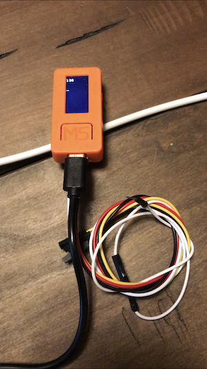

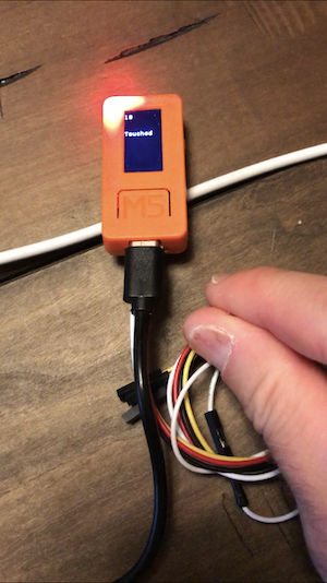

]]></description><link>https://community.m5stack.com/post/10719</link><guid isPermaLink="true">https://community.m5stack.com/post/10719</guid><dc:creator><![CDATA[xis]]></dc:creator><pubDate>Thu, 12 Nov 2020 09:48:50 GMT</pubDate></item><item><title><![CDATA[Reply to M5stickC Touch Sensing on Wed, 11 Nov 2020 22:16:20 GMT]]></title><description><![CDATA[<p dir="auto">Using <a class="plugin-mentions-user plugin-mentions-a" href="/user/felmue" aria-label="Profile: felmue">@<bdi>felmue</bdi></a>'s example, here is how I did it. For some reason I could only use the pins on the Grove port (32 or 33) of the M5StickC for capacitive touch. The GPIO pins at the top header (0, 23, 36) didn't work for me.  I understand why 23 and 36 don't work (they are not one of the capacitive touch pins on the ESP32), but pin 0 should have worked according to the MicroPython docs.</p>
<p dir="auto"><a href="http://docs.micropython.org/en/v1.11/esp32/quickref.html#capacitive-touch" target="_blank" rel="noopener noreferrer nofollow ugc">http://docs.micropython.org/en/v1.11/esp32/quickref.html#capacitive-touch</a></p>
<p dir="auto"><img src="/assets/uploads/files/1605132647495-screen-shot-2020-11-11-at-5.06.57-pm-resized.png" alt="0_1605132644839_Screen Shot 2020-11-11 at 5.06.57 PM.png" class=" img-fluid img-markdown" /></p>
<p dir="auto"><img src="/assets/uploads/files/1605132867273-img_1729.png" alt="0_1605132863786_IMG_1729.PNG" class=" img-fluid img-markdown" /><br />
<img src="/assets/uploads/files/1605132879427-img_1728.png" alt="0_1605132878725_IMG_1728.PNG" class=" img-fluid img-markdown" /></p>
