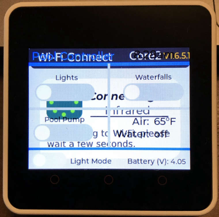

<a href="https://community.m5stack.com/topic/2435/wifi-connect-layer-still-shown">https://community.m5stack.com/topic/2435/wifi-connect-layer-still-shown</a></p>
<p dir="auto">I have the same issue as well. I didn’t realize this was related to MQTT, which I use in my Core2 program.</p>
<p dir="auto"><img src="/assets/uploads/files/1605288789664-d50e0a8a-0f0e-4c6b-bc53-b7071580751c-resized.jpeg" alt="0_1605288762320_D50E0A8A-0F0E-4C6B-BC53-B7071580751C.jpeg" class=" img-fluid img-markdown" /></p>
<p dir="auto"><a class="plugin-mentions-user plugin-mentions-a" href="/user/m5stack" aria-label="Profile: m5stack">@<bdi>m5stack</bdi></a>, please note this bug and see if you can fix it.</p>
<p dir="auto">By the way, for me it only happens when I download the program to the Core2. When pressing the Run button in uiFlow, I do not see the graphics issue.</p>
