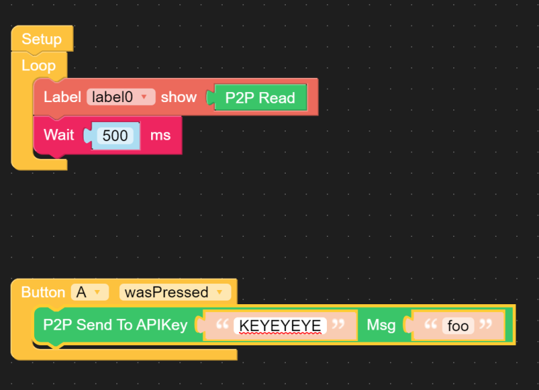

]]></description><link>https://community.m5stack.com/post/11490</link><guid isPermaLink="true">https://community.m5stack.com/post/11490</guid><dc:creator><![CDATA[plusulli]]></dc:creator><pubDate>Fri, 01 Jan 2021 13:32:13 GMT</pubDate></item><item><title><![CDATA[Reply to UIflow P2P - getP2PData() on Wed, 30 Dec 2020 22:58:53 GMT]]></title><description><![CDATA[<p dir="auto"><img src="/assets/uploads/files/1609369034760-0c26d482-5d51-4b3b-8211-6cfd03cc039b-image-resized.png" alt="0_1609369034040_0c26d482-5d51-4b3b-8211-6cfd03cc039b-image.png" class=" img-fluid img-markdown" /></p>
<p dir="auto">This works for me. The upper part loops and asks for it's data every 500ms. The lower part sends a message if button A was pressed. They key must be set to the right key of the device to send to.</p>
