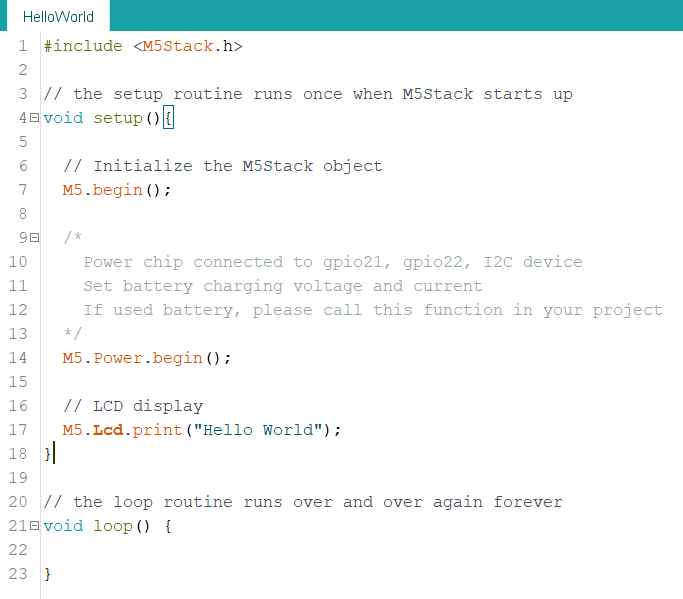

so I can burn the Core2 test application without issue, and I can code Arduino's nano's without many issues, but I can't get the hello word example to work on the core2! i just get a black screen!</p>
<p dir="auto">What am I doing wrong?</p>
<p dir="auto">I can revert from Arduino to the test program by re flashing it from the burner...</p>
<p dir="auto"><img src="/assets/uploads/files/1605994736602-hello-world.png" alt="0_1605994738590_hello world.png" class=" img-fluid img-markdown" /></p>

]]></description><link>https://community.m5stack.com/post/10826</link><guid isPermaLink="true">https://community.m5stack.com/post/10826</guid><dc:creator><![CDATA[wadoadi]]></dc:creator><pubDate>Sun, 22 Nov 2020 13:53:09 GMT</pubDate></item><item><title><![CDATA[Reply to Hello World, or not Arduino on Sat, 21 Nov 2020 22:05:07 GMT]]></title><description><![CDATA[<p dir="auto">Replace <code>#include &lt;M5Stack.h&gt;</code> with <code>#include &lt;M5Core2.h&gt;</code>.</p>
]]></description><link>https://community.m5stack.com/post/10822</link><guid isPermaLink="true">https://community.m5stack.com/post/10822</guid><dc:creator><![CDATA[vkichline]]></dc:creator><pubDate>Sat, 21 Nov 2020 22:05:07 GMT</pubDate></item></channel></rss>
