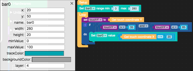

<p dir="auto">with some coding you can make a <code>Bar</code> interactive:</p>
<p dir="auto"><img src="/assets/uploads/files/1606453557458-uiflowbarasslider20201127.png" alt="0_1606453555534_UIFlowBarAsSlider20201127.png" class=" img-fluid img-markdown" /></p>
<p dir="auto">Please note: If you change <code>bar0 x, y, width or height</code> you'll need to adapt the code.</p>
