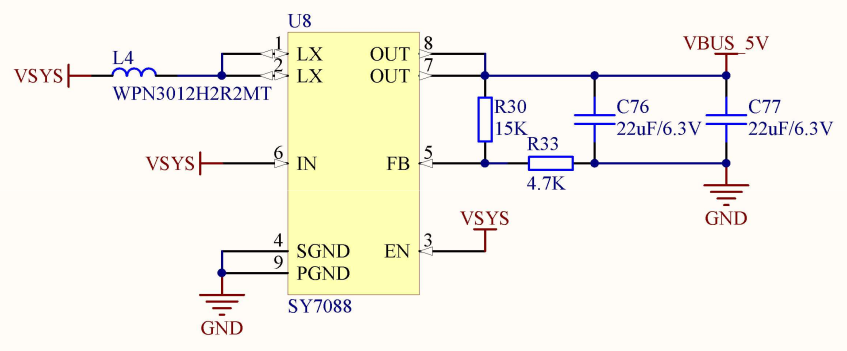

SY7088 boost regulator is used to generate a stable 5V voltage used used for all other voltages.<br />
<img src="/assets/uploads/files/1607020635133-9454cec4-4c48-4bd6-9b65-8fbe64c140a3-image-resized.png" alt="0_1607020633850_9454cec4-4c48-4bd6-9b65-8fbe64c140a3-image.png" class=" img-fluid img-markdown" /><br />
When the system is in power save and power off modes, resistors R30 &amp; R33 values causes the constant current consumption of ~254 uA which leads to quite rapid battery discharge. At least 10x higher values should be selected. From Data sheet:</p>
<pre><code class="language-To">it is desirable to choose large resistance values for both
R30 and R33 . A value of between 10kΩ and 1MΩ is
recommended for both resistors.
</code></pre>
<p dir="auto">Furthermore, SY7088 shuts off the output only at ~2.3V which couses battery overdischarge!</p>

<p dir="auto">Hello <a class="plugin-mentions-user plugin-mentions-a" href="/user/loboris" aria-label="Profile: loboris">@<bdi>loboris</bdi></a></p>
<p dir="auto">if I read the schematics correctly in power off mode signal <code>PS_ON</code> is low, <code>FET2</code> open, <code>PWR_EN</code> pulled up by <code>R35</code>,  <code>FET1</code> open, <code>VBAT</code> zero and <code>VSYS</code> zero as well, therefore the values of R30 and R33 shouldn't matter since SY7088 is without power. Or am I missing something?</p>
<p dir="auto">BTW: The RTC will drain the battery even lower as it is directly connected to the battery and runs until 1 volts.</p>
<p dir="auto">Thanks<br />
Felix</p>
<p dir="auto">Thank you, I've missed that.<br />
RTC current is &lt;1uA, so it should not be a problem.</p>
]]></description><link>https://community.m5stack.com/post/11014</link><guid isPermaLink="true">https://community.m5stack.com/post/11014</guid><dc:creator><![CDATA[loboris]]></dc:creator><pubDate>Thu, 03 Dec 2020 20:51:30 GMT</pubDate></item><item><title><![CDATA[Reply to M5Paper power management on Thu, 03 Dec 2020 20:25:56 GMT]]></title><description><![CDATA[<p dir="auto">Hello <a class="plugin-mentions-user plugin-mentions-a" href="/user/loboris" aria-label="Profile: loboris">@<bdi>loboris</bdi></a></p>
Felix</p>
