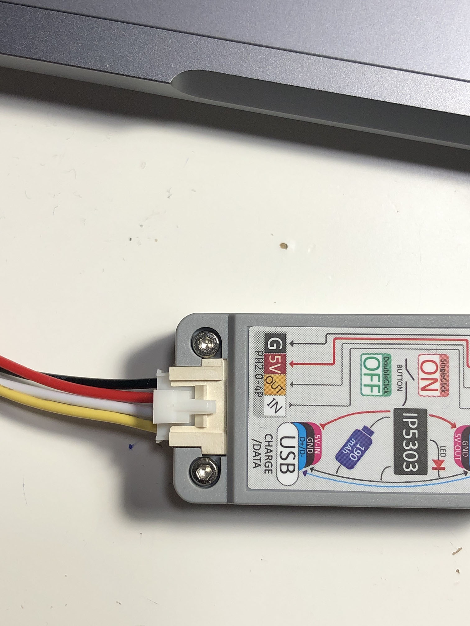

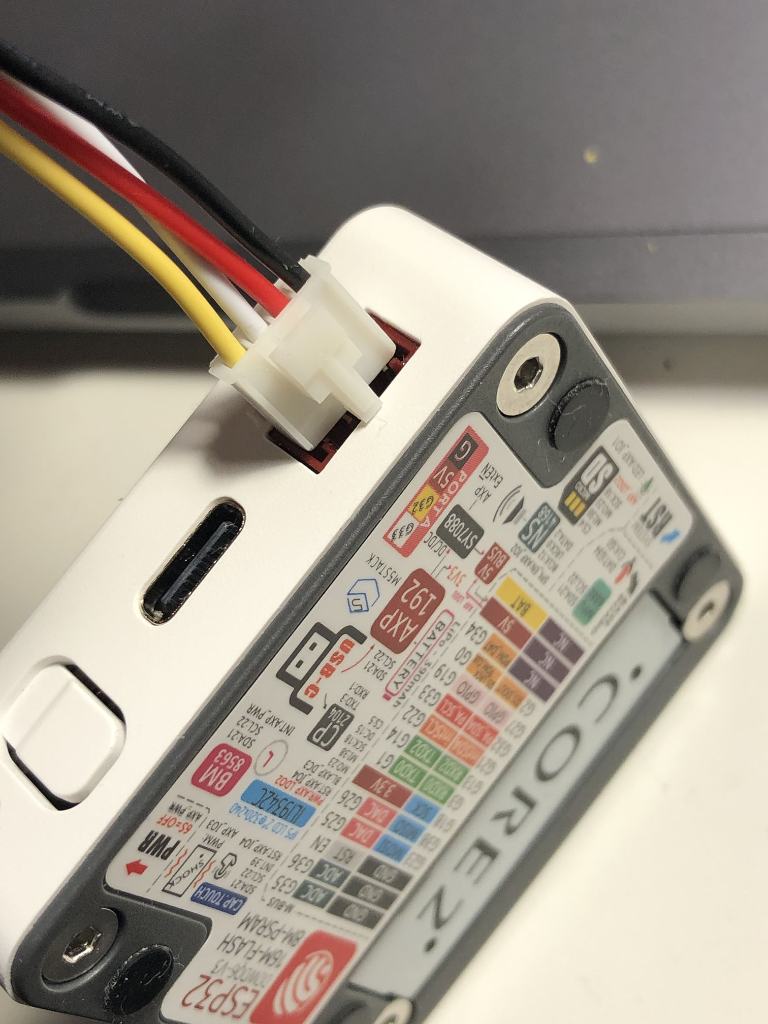

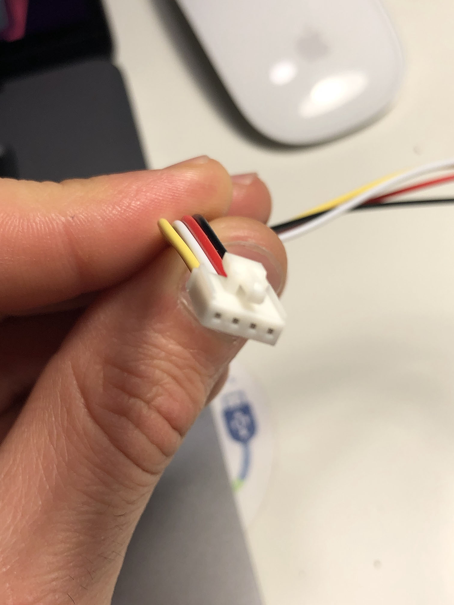

However, the cable connector doesn't fit in the Core2's grove port but fits in other parts from m5stack. I looked on seeed's website to find more information about different grove connectors but all information I find says that there is only one type... Please see the photos. <img src="/assets/uploads/files/1607235577613-img_4241-resized.jpg" alt="2_1607235552031_IMG_4241.jpg" class=" img-fluid img-markdown" /> <img src="/assets/uploads/files/1607235577011-img_4240-resized.jpg" alt="1_1607235552030_IMG_4240.jpg" class=" img-fluid img-markdown" /> <img src="/assets/uploads/files/1607235576379-img_4239-resized.jpg" alt="0_1607235552030_IMG_4239.jpg" class=" img-fluid img-markdown" /></p>

]]></description><link>https://community.m5stack.com/post/11070</link><guid isPermaLink="true">https://community.m5stack.com/post/11070</guid><dc:creator><![CDATA[innovationsmaker]]></dc:creator><pubDate>Mon, 07 Dec 2020 05:38:52 GMT</pubDate></item><item><title><![CDATA[Reply to Are all grove connectors made equal? on Sun, 06 Dec 2020 09:04:12 GMT]]></title><description><![CDATA[<p dir="auto">Grove is a standard of cable design created by seedstudio as you have noticed.</p>
<p dir="auto">It uses a 4 pin JST-PH connector with a 2mm centre between pins.</p>
<p dir="auto">There are 2 main cables latching and non latching. Latching is used for sensors and actuators that need to be connected to controllers where as non latching is needed to plug into the controller (M5Stack/ SeeedStudio Wio).<br />
You just need to snip the latch off of one end of the cable to plug into controllers or devices tat have the clip covered.</p>
<p dir="auto">There are also 2 varients of the cable on the market one has the colours Black, Red, White, Yellow, and the other has Black, Red, Yellow, White.</p>
<p dir="auto">There are however additional Seeedstudio/M5Stack cables that are<br />
Grove 2 Grove,<br />
Grove 2 Stemma,<br />
Grove 2 Dupont Male,<br />
Grove to dupont Female.</p>
