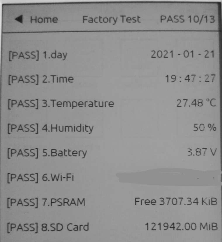

I haven't tried writing files using the M5Paper, but I can read text files and jpg files using the factorytest without any problems.</p>
<p dir="auto"><img src="/assets/uploads/files/1611255784663-img_20210121_200122-resized.jpg" alt="0_1611255703227_IMG_20210121_200122.jpg" class=" img-fluid img-markdown" /></p>
