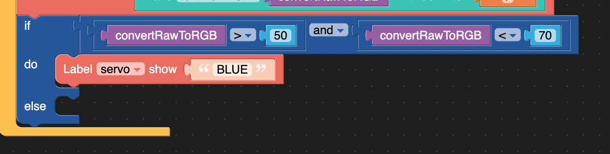

<p dir="auto">How can add multiple AND/OR cases within an if statement? See image. I only can add one AND within an if statement but I want to have more.  <img src="/assets/uploads/files/1608546158333-bildschirmfoto-2020-12-21-um-08.59.29-resized.png" alt="0_1608546156682_Bildschirmfoto 2020-12-21 um 08.59.29.png" class=" img-fluid img-markdown" /></p>
<p dir="auto">Any hints?</p>
<p dir="auto">Thanks,<br />
Mathias</p>

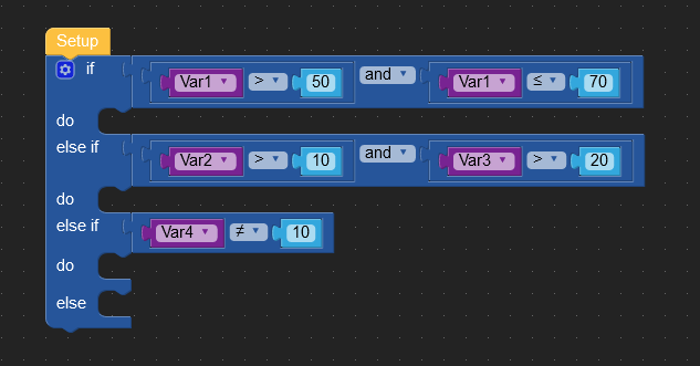

<p dir="auto"><img src="/assets/uploads/files/1608561322476-26b23538-3e72-4e79-8f44-ffa389bc809f-image-resized.png" alt="0_1608561309057_26b23538-3e72-4e79-8f44-ffa389bc809f-image.png" class=" img-fluid img-markdown" /></p>
<p dir="auto">or like this:</p>

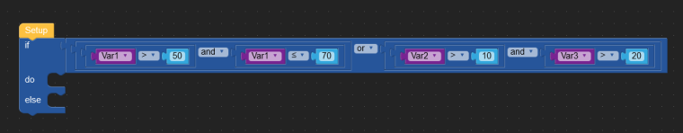

<p dir="auto"><img src="/assets/uploads/files/1608561341259-6e2086e1-ad1c-4ae0-85be-a58be76daa68-image.png" alt="0_1608561336184_6e2086e1-ad1c-4ae0-85be-a58be76daa68-image.png" class=" img-fluid img-markdown" /></p>
