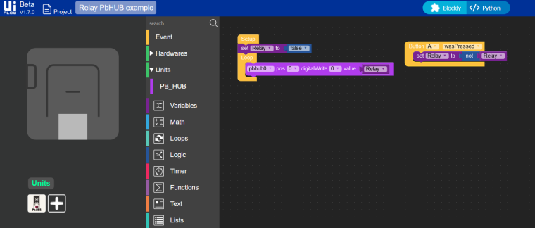

This is an example on UI Flow. The relay is connected to PbHUB port 0</p>
<p dir="auto"><img src="/assets/uploads/files/1609104144840-77cd9ae0-5c1a-42a3-974b-1037206c1a7c-image-resized.png" alt="0_1609104140897_77cd9ae0-5c1a-42a3-974b-1037206c1a7c-image.png" class=" img-fluid img-markdown" /></p>
