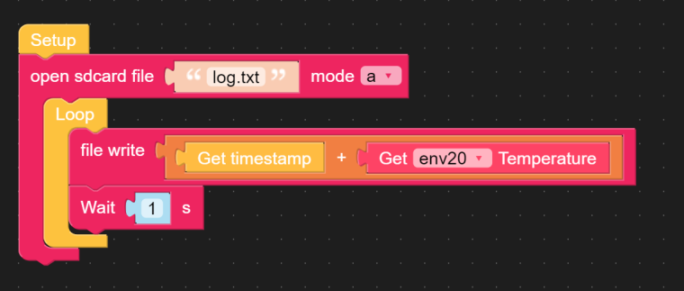

<p dir="auto">I try to save Temp Value from Unit2 every 60 Seconds in SD card with a time stamp ( sntp or etc. it is not so inportant) for Core2.</p>
<p dir="auto">Example:</p>
<p dir="auto">27.12.2020 13:20:30 / 27.2<br />
27.12.2020 13:21:30 / 26.5<br />
...<br />
.....</p>
<p dir="auto">But I could not find a solution with uiflow.</p>
<p dir="auto">Is there anyway with uiflow?</p>
<p dir="auto">If yes<br />
Please share a short info or uiflow?</p>
<p dir="auto">If no<br />
Please give an alternative solution.</p>
<p dir="auto">Thank you in advance</p>

]]></description><link>https://community.m5stack.com/post/11456</link><guid isPermaLink="true">https://community.m5stack.com/post/11456</guid><dc:creator><![CDATA[flypeek]]></dc:creator><pubDate>Thu, 31 Dec 2020 00:59:59 GMT</pubDate></item><item><title><![CDATA[Reply to Time Based Sensor Data Storage in SD Card with Uiflow on Tue, 29 Dec 2020 18:10:18 GMT]]></title><description><![CDATA[<p dir="auto">You should be able to use blocks from SDCard and ntp together with the Unit's block to something like this (not tested):</p>
<p dir="auto"><img src="/assets/uploads/files/1609265400158-08e2c8f0-b1ba-453c-9e1f-ea713b9f6a85-image-resized.png" alt="0_1609265395042_08e2c8f0-b1ba-453c-9e1f-ea713b9f6a85-image.png" class=" img-fluid img-markdown" /></p>
]]></description><link>https://community.m5stack.com/post/11420</link><guid isPermaLink="true">https://community.m5stack.com/post/11420</guid><dc:creator><![CDATA[sodoku]]></dc:creator><pubDate>Tue, 29 Dec 2020 18:10:18 GMT</pubDate></item></channel></rss>
