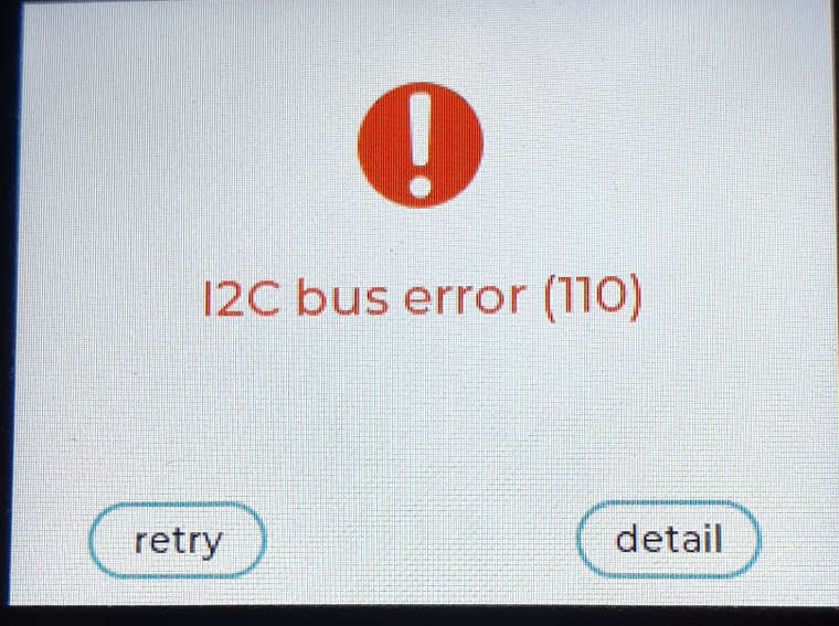

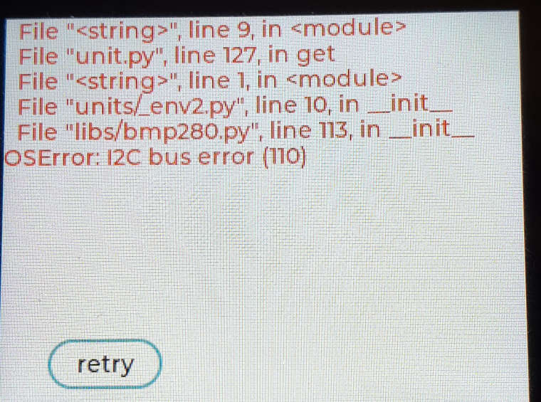

<p dir="auto">I am just wondering if the I2C failure could be a connectivity issue between M5Core2 and M5GO2? Maybe try to separate the two and then stack them again?</p>
<p dir="auto">Thanks<br />
Felix</p>
]]></description><link>https://community.m5stack.com/post/11643</link><guid isPermaLink="true">https://community.m5stack.com/post/11643</guid><dc:creator><![CDATA[felmue]]></dc:creator><pubDate>Sun, 10 Jan 2021 22:45:15 GMT</pubDate></item><item><title><![CDATA[Reply to [Core2] UiFlow - BOTTOM2 support on Sun, 10 Jan 2021 17:02:24 GMT]]></title><description><![CDATA[<p dir="auto">Fun fact ... after a while when all was working my env2 or tvoc is unable to communicate ....<br />
<img src="/assets/uploads/files/1610298020202-20210110_175915-resized.jpg" alt="0_1610297963551_20210110_175915.jpg" class=" img-fluid img-markdown" /><br />
Sounds like i will contact support ...<img src="/assets/uploads/files/1610298140885-20210110_175941-resized.jpg" alt="0_1610298037189_20210110_175941.jpg" class=" img-fluid img-markdown" /></p>
]]></description><link>https://community.m5stack.com/post/11642</link><guid isPermaLink="true">https://community.m5stack.com/post/11642</guid><dc:creator><![CDATA[OyczE]]></dc:creator><pubDate>Sun, 10 Jan 2021 17:02:24 GMT</pubDate></item><item><title><![CDATA[Reply to [Core2] UiFlow - BOTTOM2 support on Sat, 09 Jan 2021 17:39:26 GMT]]></title><description><![CDATA[<p dir="auto"><a class="plugin-mentions-user plugin-mentions-a" href="/user/felmue" aria-label="Profile: felmue">@<bdi>felmue</bdi></a> said in <a href="/post/11623">[Core2] UiFlow - BOTTOM2 support</a>:</p>

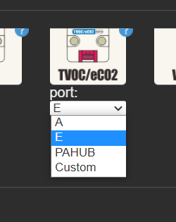

<img src="/assets/uploads/files/1609442836848-8730f1aa-72f0-4ec6-acc8-f327ad4701ea-image.png" alt="0_1609442825137_8730f1aa-72f0-4ec6-acc8-f327ad4701ea-image.png" class=" img-fluid img-markdown" /></p>
<p dir="auto">maybe the old idea with add a a core as the unit would be better.</p>
]]></description><link>https://community.m5stack.com/post/11480</link><guid isPermaLink="true">https://community.m5stack.com/post/11480</guid><dc:creator><![CDATA[OyczE]]></dc:creator><pubDate>Thu, 31 Dec 2020 19:27:59 GMT</pubDate></item><item><title><![CDATA[Reply to [Core2] UiFlow - BOTTOM2 support on Thu, 31 Dec 2020 19:06:42 GMT]]></title><description><![CDATA[<p dir="auto">Hey <a class="plugin-mentions-user plugin-mentions-a" href="/user/zontex" aria-label="Profile: Zontex">@<bdi>Zontex</bdi></a> you mean this ?<br />
<img src="/assets/uploads/files/1609441580486-0d9721be-17af-4289-b101-c7d84d843f21-image-resized.png" alt="0_1609441567820_0d9721be-17af-4289-b101-c7d84d843f21-image.png" class=" img-fluid img-markdown" /></p>
<p dir="auto">if Yes this is not working on my core2 + bottom.</p>
]]></description><link>https://community.m5stack.com/post/11479</link><guid isPermaLink="true">https://community.m5stack.com/post/11479</guid><dc:creator><![CDATA[OyczE]]></dc:creator><pubDate>Thu, 31 Dec 2020 19:06:42 GMT</pubDate></item><item><title><![CDATA[Reply to [Core2] UiFlow - BOTTOM2 support on Wed, 30 Dec 2020 10:52:58 GMT]]></title><description><![CDATA[<p dir="auto">There is support already, you can go to the hardware tab and get the RGB and IMU which are located on Bottom2 as well - they have the same pin map as Core2.</p>
