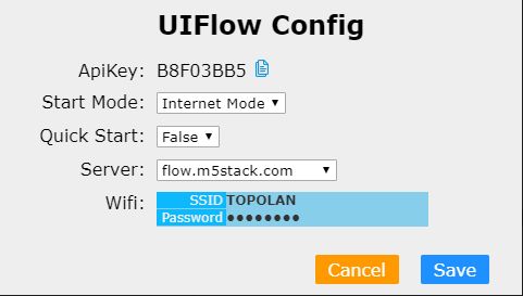

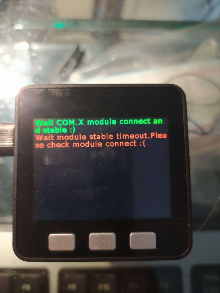

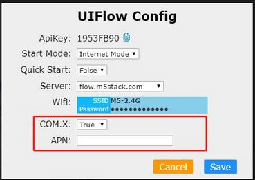

<p dir="auto">On the Core display I am a able to select COM.LTE as additional connectivity as shown <a href="https://twitter.com/its_hard_2_name/status/1334785139382001666/photo/3" target="_blank" rel="noopener noreferrer nofollow ugc">here</a>.<br />
BUT the next picture  <img src="/assets/uploads/files/1610609392867-m5burner2.jpg" alt="0_1610609391974_M5Burner2.jpg" class=" img-fluid img-markdown" /> (I guess taken from M5Burner configuration, right?) is different in my case because it shows only WiFi, while the APN section is missing  <img src="/assets/uploads/files/1610608432132-m5burner.jpg" alt="0_1610608430876_M5Burner.jpg" class=" img-fluid img-markdown" />.<br />
The final result is that if I select on the Core display COM.LTE and reboot it fails to connect. <img src="/assets/uploads/files/1610608671291-com.x-attempt-resized.jpg" alt="0_1610608668641_COM.X attempt.jpg" class=" img-fluid img-markdown" />.<br />
Please note that the modem is working fine, since I'm able to drive it with my UIFlow code (via AT commands) moving data back and forth perfectly.<br />
My ultimate need is to use the UIFlow MQTT client not through the WiFi but natively through the mobile connection.<br />
THANKS!</p>
