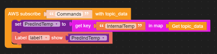

]]></description><link>https://community.m5stack.com/post/21219</link><guid isPermaLink="true">https://community.m5stack.com/post/21219</guid><dc:creator><![CDATA[ajb2k3]]></dc:creator><pubDate>Fri, 16 Jun 2023 18:28:58 GMT</pubDate></item><item><title><![CDATA[Reply to Accessing decoded JSON array on Thu, 15 Jun 2023 19:57:35 GMT]]></title><description><![CDATA[<p dir="auto"><a class="plugin-mentions-user plugin-mentions-a" href="/user/kombistack" aria-label="Profile: kombistack">@<bdi>kombistack</bdi></a> Im trying to do something similar to this. I'm subscribing to an AWS IOT topic which is publishing a JSON. I can receive the whole message but in trying to extract one field from the JSON its not returning anything. Pic below</p>
<p dir="auto"><img src="/assets/uploads/files/1686859049160-197a7526-c043-4220-8830-205522146090-image-resized.png" alt="0_1686859057609_197a7526-c043-4220-8830-205522146090-image.png" class=" img-fluid img-markdown" /></p>

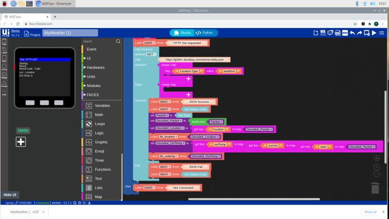

Hello,<br />
Yes your answer is correct, I have just found the answer just before you replied!!<br />
See attached screenshot.</p>
<p dir="auto"><img src="/assets/uploads/files/1609603158019-uiflow_json_decode-resized.png" alt="0_1609603120284_UIFlow_JSON_Decode.png" class=" img-fluid img-markdown" /><br />
Many thanks for the advice.<br />
Regards<br />
Phil</p>
