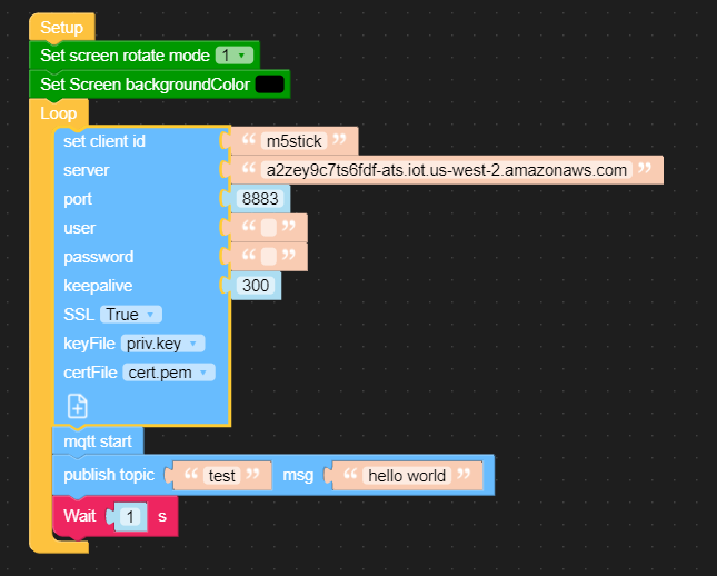

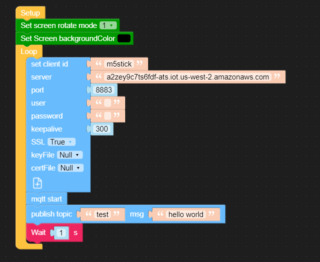

<ol>
<li>Connect your device to UIFlow. Create a new MQTT block that looks like this, using your own URL:</li>
</ol>
<p dir="auto"><img src="/assets/uploads/files/1609661085944-example.png" alt="0_1609661085404_example.png" class=" img-fluid img-markdown" /></p>
<ol start="2">
<li>Change the port to <code>8883</code>. This is important, don't forget it. AWS runs MQTT on a non-standard port.</li>
<li>Click on the plus icon to upload your cert.pem and priv.key files onto your device. They will then be available in the pulldown menus.</li>
</ol>
<p dir="auto"><img src="/assets/uploads/files/1609661205877-example2.png" alt="0_1609661203820_example2.png" class=" img-fluid img-markdown" /></p>

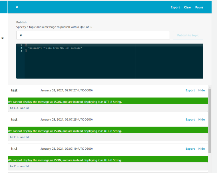

<li>Finally, run the code on your device. You will now begin to see "hello world" messages appearing in the queue every second:</li>
</ol>
<p dir="auto"><img src="/assets/uploads/files/1609661278374-b0bd34a6-fc22-48f9-9eab-2d3331e803a3-image-resized.png" alt="0_1609661277903_b0bd34a6-fc22-48f9-9eab-2d3331e803a3-image.png" class=" img-fluid img-markdown" /></p>

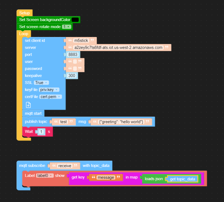

<p dir="auto">Here's one last screenshot that includes an example of how to subscribe to messages on your device.  In this example you'd Publish a test message to the 'receive' topic. Just make sure you have a label0 somewhere on the screen.</p>
<p dir="auto"><img src="/assets/uploads/files/1609664736151-6227262f-c431-4a03-b840-2822e018980d-image-resized.png" alt="0_1609664735105_6227262f-c431-4a03-b840-2822e018980d-image.png" class=" img-fluid img-markdown" /></p>
