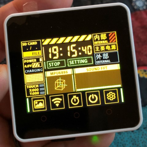

<p dir="auto">just to be clear, when you run the Factory Test the screen in your M5Core2 works, correct? correct. here's a screenshot of the test running:</p>
<p dir="auto">![alt text](<img src="/assets/uploads/files/1609747949307-img-2857-small.jpg" alt="0_1609747947765_IMG-2857 (Small).jpg" class=" img-fluid img-markdown" /> image url)</p>
<p dir="auto">After burning UIFlow, have you tried to reset your M5Stack with the reset button?<br />
Also have you tried to fully shutdown your M5Stack by pressing and holding the power button, then power it on again?</p>
<p dir="auto">the device has been reset and turned off and on multiple times indeed.<br />
so weir, I reckon...</p>
