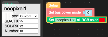

<p dir="auto">I think I found the issue. By default M5Core2 (running UIFlow 1.7.1) does not enable the internal 5 volts boost, therefore the LEDs are not powered.</p>
<p dir="auto"><a class="plugin-mentions-user plugin-mentions-a" href="/user/greenleaf" aria-label="Profile: greenleaf">@<bdi>greenleaf</bdi></a> when I add the following two lines to your Python code it works for me:</p>
power.setBusPowerMode(0)
</code></pre>
<p dir="auto"><a class="plugin-mentions-user plugin-mentions-a" href="/user/veryalien" aria-label="Profile: veryalien">@<bdi>veryalien</bdi></a> for UIFlow add: Hardwares - Power - Set bus power mode (0), then use RGB LED unit set to Custom and SDA/TX set to 25 and Number set to 10.<br />
<img src="/assets/uploads/files/1609857133602-uiflowrgbled_20210105.png" alt="0_1609857130429_UIFlowRGBLED_20210105.png" class=" img-fluid img-markdown" /></p>
<p dir="auto">Happy Stacking!<br />
Felix</p>

<p dir="auto">I can now have the built-in AWS Core2 bottom LED bar lit up, by using it as a RGB LED strip on pin 25.</p>
<p dir="auto">I can now have M5 RGB units and strips on any of the ports A, B, or C.</p>
