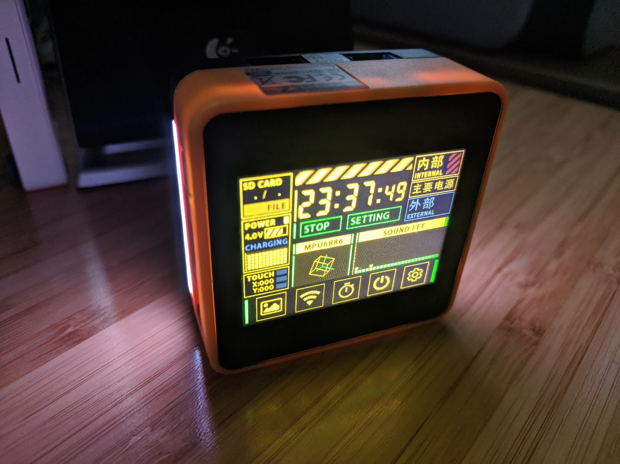

<p dir="auto">Connect your M5Core2 and build/upload. You can do CTRL-Shift-P to find the Platformio:Upload option.</p>
</li>
<li>
<p dir="auto">Play with the cool factory demo!</p>
</li>
</ol>
<p dir="auto"><img src="/assets/uploads/files/1609803298975-m5-resized.jpg" alt="0_1609803302370_m5.jpg" class=" img-fluid img-markdown" /></p>
