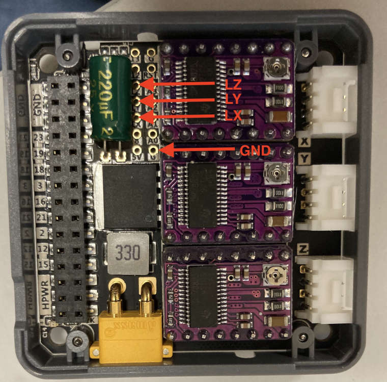

<p dir="auto">I'm working on a project with the M5Stack Core and the Stepmotor Module.<br />
GRBL 0.8c is pre-installed on the Module. It offers a "Hard Limit" Option ($16=1) to set a switch that turns off the motor when the "Home" Position is reached.<br />
Usually the Pin for the X-Motor-Hard-Limit would be "D9" on an Arduino. Does any one know how to connect an End-Switch on the Stepmotor  Module since there is no  D9 Pin?</p>

<p dir="auto"><img src="/assets/uploads/files/1615326409452-limits-resized.jpg" alt="0_1615326406983_Limits.jpg" class=" img-fluid img-markdown" /></p>
