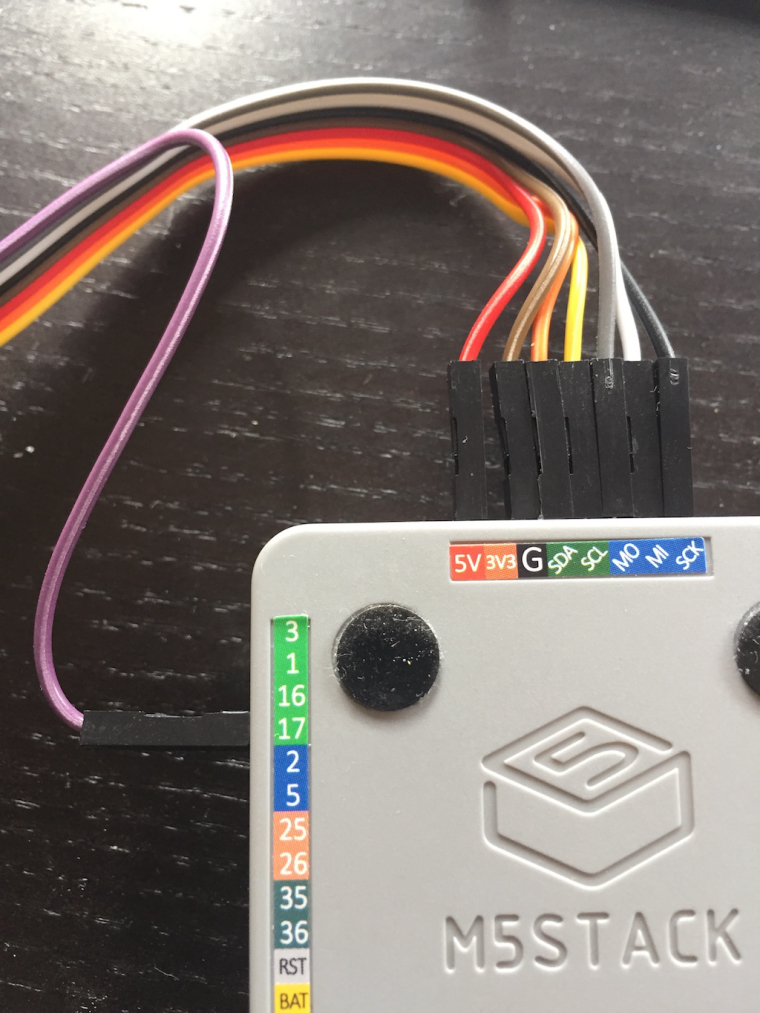

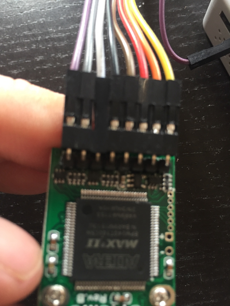

<p dir="auto">Simply buy the cam at the link supplied and hook it up with the pin-socket-wires that come with the camera as follows:</p>
<p dir="auto"><img src="/assets/uploads/files/1533130506288-img_1767-resized.jpg" alt="0_1533130431253_IMG_1767.jpg" class=" img-fluid img-markdown" /></p>
<p dir="auto"><img src="/assets/uploads/files/1533130640210-img_1766-resized.jpg" alt="0_1533130575218_IMG_1766.jpg" class=" img-fluid img-markdown" /></p>
<p dir="auto">Then clone <a href="https://github.com/ArduCAM/ArduCAM_ESP32S_UNO" target="_blank" rel="noopener noreferrer nofollow ugc">https://github.com/ArduCAM/ArduCAM_ESP32S_UNO</a> and copy the ArduCAM and  ESP32WebServer libraries to your Arduino/libraries directory, add the client or AP data to the example script from the github (ArduCAM_ESP32S_UNO/libraries/ArduCAM/examples/ESP32/ArduCAM_ESP32_Capture/ArduCAM_ESP32_Capture.ino). Also make sure you uncomment <code>#define OV2640_CAM</code> and <code>#define OV2640_MINI_2MP</code> in the <code>memorysaver.h</code> file in the Arducam library dir, run the script and a webcam webserver works. (Surf to <code>&lt;ip&gt;/stream</code> or <code>&lt;ip&gt;/capture</code>).</p>
