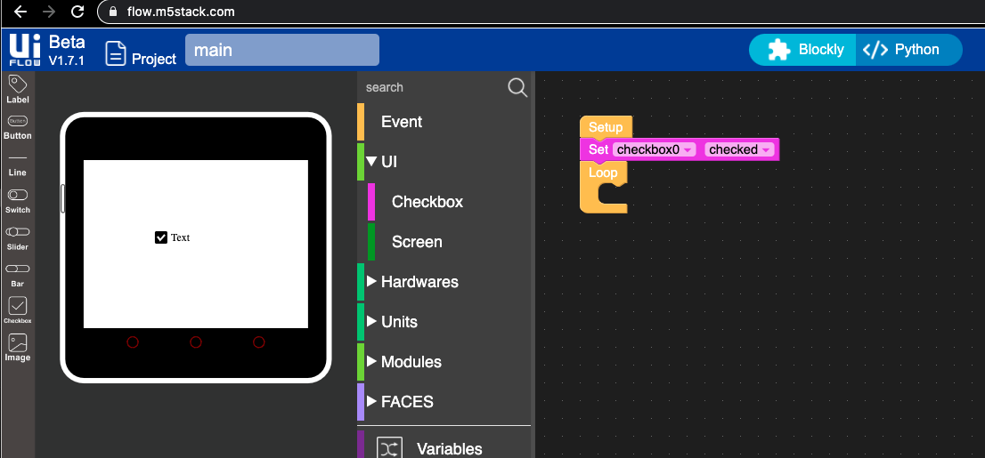

<p dir="auto">I'am using UiFlow Beta V1.7.1 with Core2 (v1.7.1-core2 firmware). The block Set checkbox checked seems doesn't really work after running on the device, checkbox remain unchecked.</p>
<p dir="auto"><img src="/assets/uploads/files/1609988345417-screen-shot-2021-01-07-at-3.50.41-am-resized.png" alt="0_1609988337865_Screen Shot 2021-01-07 at 3.50.41 AM.png" class=" img-fluid img-markdown" /></p>

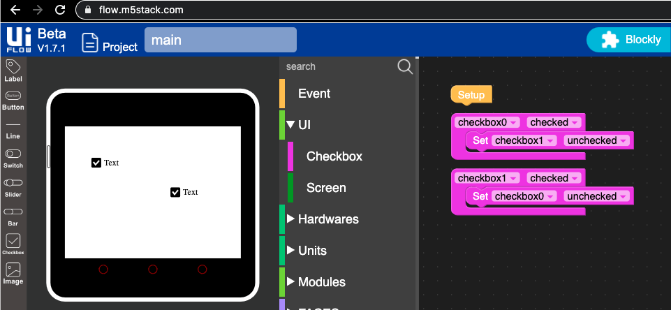

<p dir="auto">When I use set_checked for toggling two checkboxes, it seems to work only sometimes.</p>
<p dir="auto"><img src="/assets/uploads/files/1609990539874-screen-shot-2021-01-07-at-4.23.21-am-resized.png" alt="0_1609990536942_Screen Shot 2021-01-07 at 4.23.21 AM.png" class=" img-fluid img-markdown" /></p>

]]></description><link>https://community.m5stack.com/post/11912</link><guid isPermaLink="true">https://community.m5stack.com/post/11912</guid><dc:creator><![CDATA[felmue]]></dc:creator><pubDate>Thu, 21 Jan 2021 15:19:05 GMT</pubDate></item><item><title><![CDATA[Reply to Core2 checkbox set_checked doesn&#x27;t work on Wed, 20 Jan 2021 20:28:07 GMT]]></title><description><![CDATA[<p dir="auto"><a class="plugin-mentions-user plugin-mentions-a" href="/user/mwenghi" aria-label="Profile: mwenghi">@<bdi>mwenghi</bdi></a> I've worked out that set_checked <em>does</em> actually work. It changes the internal state of the checkbox from unchecked to checked, but it's not changing the visible state of the checkbox on the screen, so it doesn't appear to do anything!</p>
<p dir="auto">If you add a set_checked_color call (in blockly it's the block set selectedColor) after your set_checked it will then show the relevant checkbox as checked in your desired color.</p>
