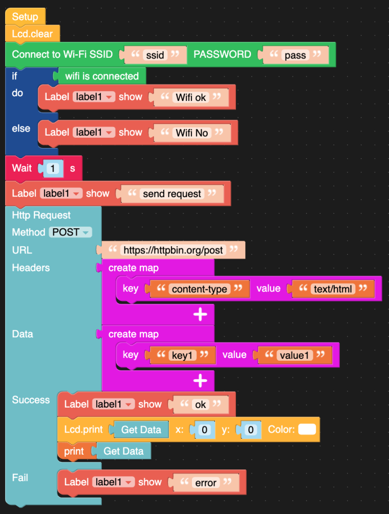

<p dir="auto"><img src="/assets/uploads/files/1611257579210-screen-shot-2021-01-21-at-2.28.52-pm-resized.png" alt="0_1611257442757_Screen Shot 2021-01-21 at 2.28.52 PM.png" class=" img-fluid img-markdown" /></p>
<p dir="auto">If you would like further help troubleshooting, you'll need to provide more detail...</p>
