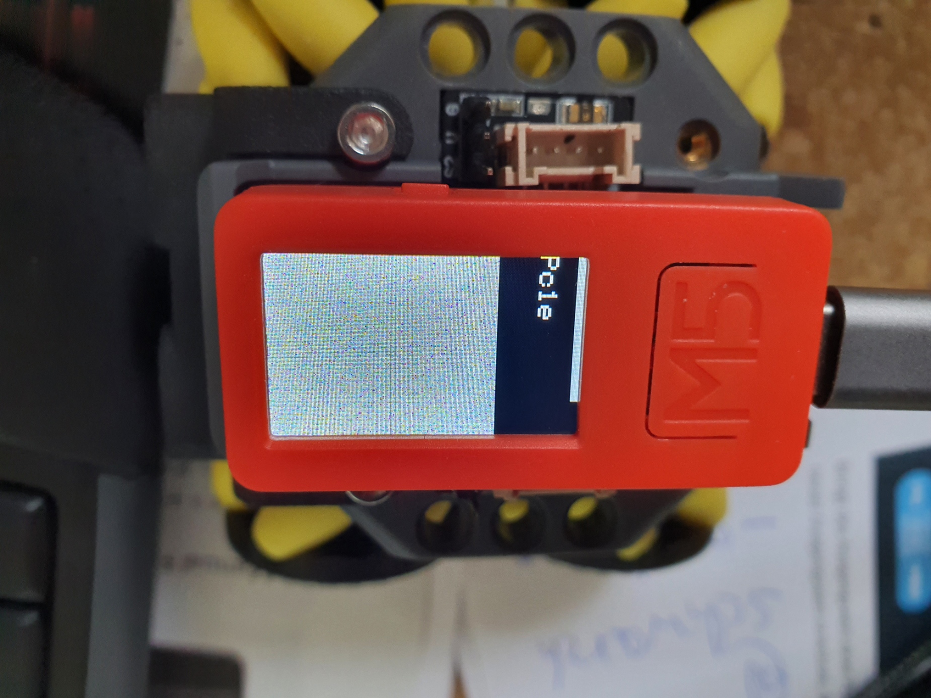

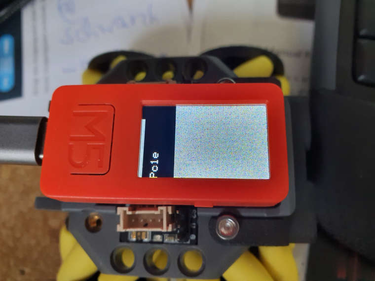

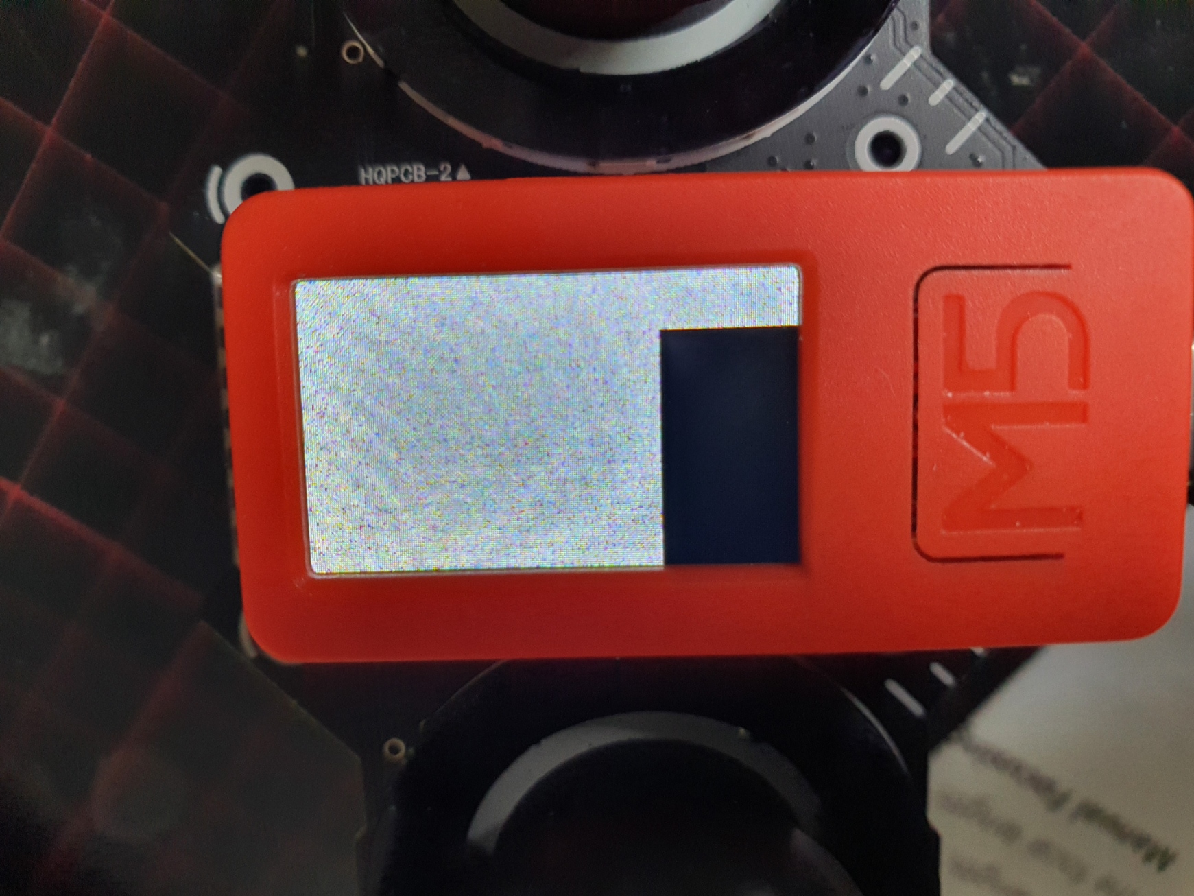

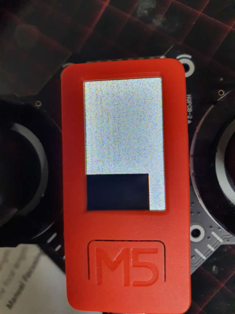

<?xml version="1.0" encoding="UTF-8"?><rss xmlns:dc="http://purl.org/dc/elements/1.1/" xmlns:content="http://purl.org/rss/1.0/modules/content/" xmlns:atom="http://www.w3.org/2005/Atom" version="2.0"><channel><title><![CDATA[RoverC + JoyC strange displays - Are the sticks broken ?]]></title><description><![CDATA[<p dir="auto">I have 2 M5Stick CPlus and use it with the RoverC plus and the JoxC .<br />
After a Iittle while I get them working - but both displays are not showing that, what is shown on the M5Stack website.<br />
NO IP adress and no charging level.</p>

<p dir="auto">I can push the buttons in every way - the display is not changing.</p>
<p dir="auto">I can bring them to work and I think the function is what it should be.</p>

<p dir="auto">no, I don't think your M5StickC Plus devices are broken. The issue is that the Arduino examples written for RoverC and JoyC are for the M5StickC (not Plus) which has a smaller screen. The M5Stack engineers will have to adapt the examples to the bigger screen.</p>
<p dir="auto">As a test you could install and run the <a href="https://github.com/m5stack/M5StickC-Plus/blob/master/examples/Basics/Display/Display.ino" target="_blank" rel="noopener noreferrer nofollow ugc">display example</a> written for M5StickC Plus to verify the screens are fine.</p>
<p dir="auto">Thanks<br />
