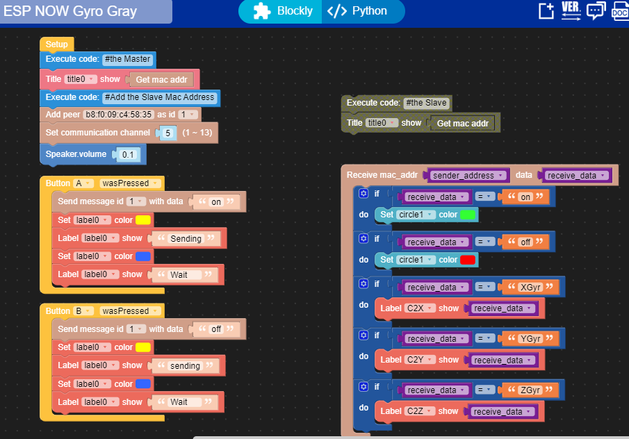

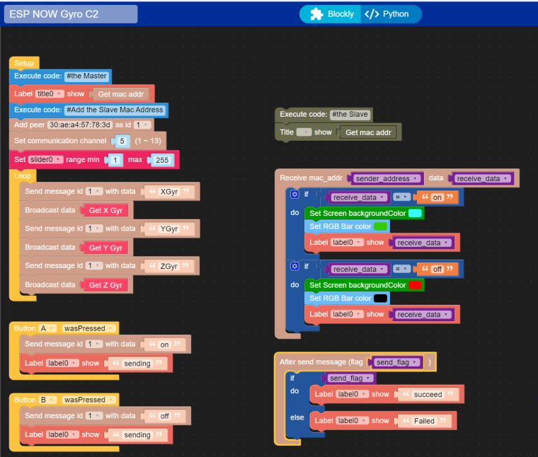

<?xml version="1.0" encoding="UTF-8"?><rss xmlns:dc="http://purl.org/dc/elements/1.1/" xmlns:content="http://purl.org/rss/1.0/modules/content/" xmlns:atom="http://www.w3.org/2005/Atom" version="2.0"><channel><title><![CDATA[code example for remote control between two M5stacks]]></title><description><![CDATA[<p dir="auto">I am new to my M5stacks. I have a M5stack gray and a core2, I want with ESP NOW to communicate the X, Y and Z values of the gyro of the core2 and enter them as variable X, Y and Z in the M5STACK Gray.<br />
By following the documentation I manage to communicate ON / OFF between the two systems but not with numerical values.</p>

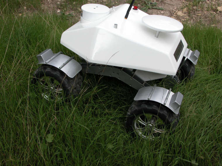

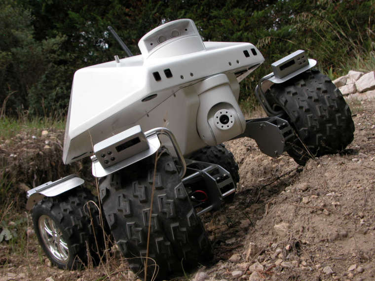

I also block to exchange data in ESP NOW.<img src="/assets/uploads/files/1611911657018-dscn1339-resized.jpg" alt="0_1611911655795_DSCN1339.JPG" class=" img-fluid img-markdown" /> <img src="/assets/uploads/files/1611911701114-dscn1327-resized.jpg" alt="0_1611911701224_DSCN1327.JPG" class=" img-fluid img-markdown" /></p>
