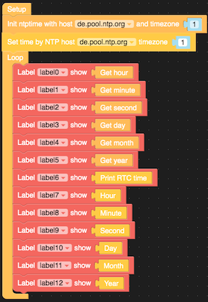

<p dir="auto">ok, I think I see now what you mean. Interestingly there seems to be a difference between <code>Hardware - RTC</code> and <code>Advanced - NTP</code>. Using the functions from RTC then yes, the hour is off by 1. If I use the NTP functions, the hour is correct.</p>
<p dir="auto"><img src="/assets/uploads/files/1611401719362-uiflowrtcvsntptest.png" alt="0_1611401715441_UIFlowRTCvsNTPTest.png" class=" img-fluid img-markdown" /></p>
<p dir="auto">Thanks<br />
Felix</p>
