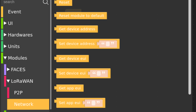

<p dir="auto">As @LasNiko , I plan to try the same :Using old blue LORAWAN Module (LORA868) to send data to TTN.</p>
<p dir="auto">Would you have any insights on the commands to use by any chance ?</p>
<p dir="auto">Blocks exists in UIFLOW 1.8.2 but hard to find documentations related to it</p>
<p dir="auto"><img src="/assets/uploads/files/1629795655205-87e75100-4779-45fb-b249-bc0c096a98cd-image-resized.png" alt="0_1629795653114_87e75100-4779-45fb-b249-bc0c096a98cd-image.png" class=" img-fluid img-markdown" /></p>
<p dir="auto">Cheers,</p>
<p dir="auto">bob_isat</p>
