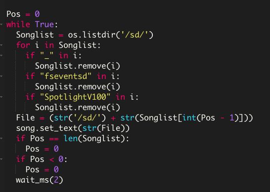

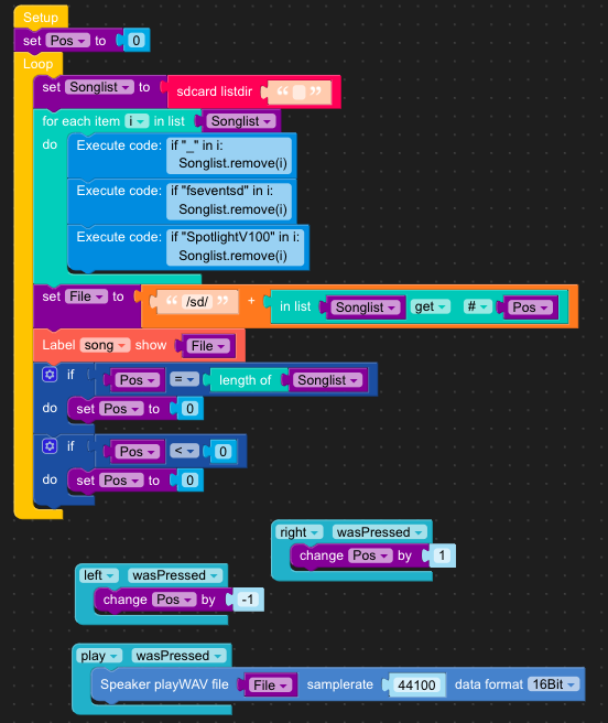

<?xml version="1.0" encoding="UTF-8"?><rss xmlns:dc="http://purl.org/dc/elements/1.1/" xmlns:content="http://purl.org/rss/1.0/modules/content/" xmlns:atom="http://www.w3.org/2005/Atom" version="2.0"><channel><title><![CDATA[One of M5stacks tutorials doesn&#x27;t work for me- WAV player]]></title><description><![CDATA[<p dir="auto">Hello! I wanted to replicate a tutorial made by M5Stack but I don't get the same results. The tutorial: <a href="https://www.youtube.com/watch?v=AYIVRIQj6gE&amp;t=607s&amp;ab_channel=M5Stack" target="_blank" rel="noopener noreferrer nofollow ugc">https://www.youtube.com/watch?v=AYIVRIQj6gE&amp;t=607s&amp;ab_channel=M5Stack</a></p>
<p dir="auto">I get an error (OSError: [Errno 19] ENODEV) (line 47) and I have no idea what to do, please help.</p>
<p dir="auto">I will post pictures on the block and some of the code, line 47 should correspond to the block "set Songlist to sdcard listdir ' ' "</p>
<p dir="auto"><img src="/assets/uploads/files/1611601061335-ska-rmavbild-2021-01-25-kl.17.06.56.png" alt="0_1611601058623_Skärmavbild 2021-01-25 kl. 17.06.56.png" class=" img-fluid img-markdown" /></p>
<p dir="auto"><img src="/assets/uploads/files/1611601145029-ska-rmavbild-2021-01-25-kl.17.06.47.png" alt="0_1611601126665_Skärmavbild 2021-01-25 kl. 17.06.47.png" class=" img-fluid img-markdown" /> !</p>

Could you please send me the m5f, too?</p>

]]></description><link>https://community.m5stack.com/post/12171</link><guid isPermaLink="true">https://community.m5stack.com/post/12171</guid><dc:creator><![CDATA[morrischen]]></dc:creator><pubDate>Fri, 29 Jan 2021 22:22:29 GMT</pubDate></item><item><title><![CDATA[Reply to One of M5stacks tutorials doesn&#x27;t work for me- WAV player on Fri, 29 Jan 2021 22:15:31 GMT]]></title><description><![CDATA[<p dir="auto"><a class="plugin-mentions-user plugin-mentions-a" href="/user/iamliubo" aria-label="Profile: IAMLIUBO">@<bdi>IAMLIUBO</bdi></a> <a class="plugin-mentions-user plugin-mentions-a" href="/user/kiko62" aria-label="Profile: Kiko62">@<bdi>Kiko62</bdi></a> <a class="plugin-mentions-user plugin-mentions-a" href="/user/zontex" aria-label="Profile: Zontex">@<bdi>Zontex</bdi></a> I downloaded the latest firmware (V1.7.2) and the code now works. Thanks for your time</p>
]]></description><link>https://community.m5stack.com/post/12170</link><guid isPermaLink="true">https://community.m5stack.com/post/12170</guid><dc:creator><![CDATA[morrischen]]></dc:creator><pubDate>Fri, 29 Jan 2021 22:15:31 GMT</pubDate></item><item><title><![CDATA[Reply to One of M5stacks tutorials doesn&#x27;t work for me- WAV player on Fri, 29 Jan 2021 21:56:04 GMT]]></title><description><![CDATA[<p dir="auto"><a class="plugin-mentions-user plugin-mentions-a" href="/user/kiko62" aria-label="Profile: kiko62">@<bdi>kiko62</bdi></a> The Wav file is in english yes</p>

]]></description><link>https://community.m5stack.com/post/12076</link><guid isPermaLink="true">https://community.m5stack.com/post/12076</guid><dc:creator><![CDATA[Kiko62]]></dc:creator><pubDate>Thu, 28 Jan 2021 04:15:51 GMT</pubDate></item><item><title><![CDATA[Reply to One of M5stacks tutorials doesn&#x27;t work for me- WAV player on Wed, 27 Jan 2021 11:34:38 GMT]]></title><description><![CDATA[<p dir="auto">Hello! Thanks for replying, I have sent the file to <a href="mailto:liubo@m5stack.com" target="_blank" rel="noopener noreferrer nofollow ugc">liubo@m5stack.com</a></p>

And  UIFlow version is?</p>
