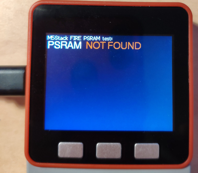

]]></description><link>https://community.m5stack.com/topic/283/m5stack-fire-faild-to-init-psram</link><generator>RSS for Node</generator><lastBuildDate>Wed, 29 Apr 2026 04:11:32 GMT</lastBuildDate><atom:link href="https://community.m5stack.com/topic/283.rss" rel="self" type="application/rss+xml"/><pubDate>Sun, 05 Aug 2018 08:55:51 GMT</pubDate><ttl>60</ttl><item><title><![CDATA[Reply to M5Stack FIRE, faild to init PSRAM on Tue, 22 Jan 2019 10:59:34 GMT]]></title><description><![CDATA[<p dir="auto">I'll try that when I get home,<br />
The m5burner from <a href="https://m5stack.com/download" target="_blank" rel="noopener noreferrer nofollow ugc">the m5stack download page.</a> also has a check psram option and that showed this, maybe handy for people in the feature that want to check if it is working.<br />
<img src="/assets/uploads/files/1548154647561-img_20190121_235152-resized.jpg" alt="0_1548154642916_IMG_20190121_235152.jpg" class=" img-fluid img-markdown" /></p>
